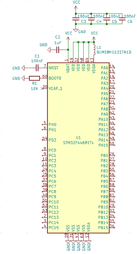

minimum wiring STM32F446
i want to know if i did the wiring correct?
The 4 x 100nF will be connected close to PIN 19, 32, 48 and 64.
PIN 1 got a 1uF.
On PIN 13 (VDDA) i added a bead as well.
NRST will not be used in the final application, is the 100nF anyway needed?
BOOT0 is grounded by 10k.
VSS is directly connected to ground. In the Nucleo Board description i saw that PIN 31 and PIN 47 could be connected to a 2.2uF, does someone know why? There is a solder bridge.

1) On the pcb, where is the right place to put that cap? Are there any recomendations?
AN4488:
"8.3 Power supply decoupling
All power supply and ground pins must be properly connected to the power supplies. These
connections, including pads, tracks and vias should have as low impedance as possible.
This is typically achieved with thick track widths and, preferably, the use of dedicated power
supply planes in multilayer PCBs.
In addition, each power supply pair should be decoupled with filtering Ceramic capacitors
(100 nF) and one single Tantalum or Ceramic capacitor (min. 4.7 µF typ.10 µF) connected in
parallel. These capacitors need to be placed as close as possible to, or below, the
appropriate pins on the underside of the PCB. Typical values are 10 nF to 100 nF, but exact
values depend on the application needs."
2) VDDA (PIN_13) got a BEAD. After that BEAD, there are two caps in parallel 1uF and 100nF to GND, correct?
AN 4488: "Additional precautions can be taken to filter analog noise:
– VDDA can be connected to VDD through a ferrite bead.
– The VREF+ pin can be connected to VDDA through a resistor."
As example check the MB1136-Nucleo STM32F446 schematic:
https://www.st.com/resource/en/schematic_pack/nucleo_64pins_sch.zip
or the MB997-STM32F407 Discovery one :
https://www.st.com/resource/en/schematic_pack/mb997-f407vgt6-e01_schematic.pdf
3) i placed a picture of my Layout (i changed it slightly after reading AN4488). Could u please have a short look?
VDDA (Pin 13) capacitors are missing ?

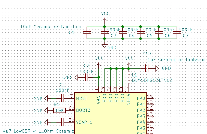

VCAP needs a capacitor, guessing 4.7uF in the single up case, but at least 2.2uF, this is for the onboard LDO (1.25V)
Bulk capacitors are there to supply instantaneous current, ie CMOS switching current, they play a different role to the decoupling capacitors which are there to pass high frequency noise.

I read the document, indeed really helpful. But some questions are left open to me. Most probably for someone with more experience its obvious and the AN4488 is self-explaining. But I need some help, maybe you could support?
1) I learned from AN4488 that i need a 10uF capacitor in parallel to the 100nF. On the pcb, where is the right place to put that cap? Are there any recomendations?

JDirk.1
JDirk.1Author
Apr 21, 2021 6:56 PM UTC
Thank you very much! Yes, two capacitors for PIN 13 were missing. I added them. I also learned i have to place them before the Bead, close to the PIN.
The question for the 10uF (where to place it) for the package was not answered but i found out that i need to place it close to the source of VCC.
Piranha
Principal III
May 22, 2021 8:58 AM UTC
The VCC source has it's own capacitors, but the C9 10uF is a bulk local source for the MCU close to it. VCC must be routed first to the C9 and from that further to C2-7 placed directly at VDD/VBAT pins.
