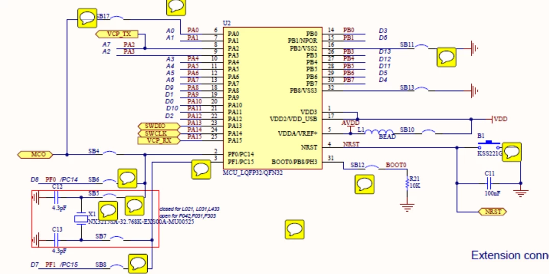

My MCU is stm32L432kc. I've concluded that we need a minimum of 4 connections: SWCLK, SWIO, vcc and gnd. Can someone from here confirm that?
And another question is I'm confused how to connect the Vdda/Vref+ pin 5 and the NRST pin4. Do I have to connect them? I have the schematic of nucleo board for my MCU attached. Should I just connect them the same way?

I'd lean toward having a pull-up on NRST, and also providing it on a debug interface, will help recover when the code does odd things, or sleeps the processor.
PB3/SWO/TDO is also recommended for a CM4 debug communication channel, ie SWV Serial Wire Viewer.

SWCLK and SWDIO and GND may also be enough. E.g. if VCC on your board is 3.3 Volt and you connect to the SWD connector on a nucleo or discovery board. NRST should have a 100 n to round. VDDA should at least be connected to VDD or clean voltage derived from VDD

GND, SWDIO, SWDCLK and MCU Vdd (for monitoring purpose) are the minimum required connectivity with ST Link for debugging.

@Community member​  I'm guessing the SWO is the MCO in my nucleo board in the pic I attached. So without it I can't use the printf function and debug through serial?

No, I'm talking about PB3
The MCO (from PA8 on an ST-LINK) is presumably a clock source.
