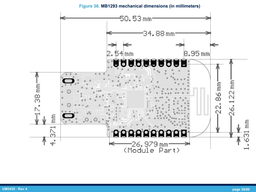

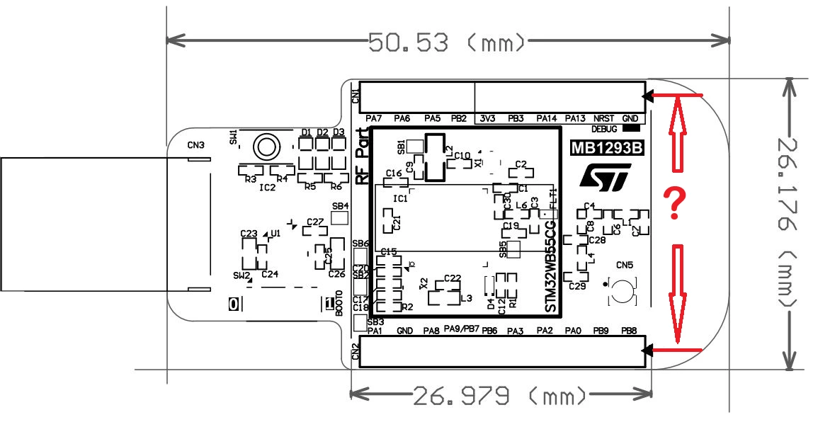

Mechanical drawing missing dimensions MB1293 USB dongle
I’m using the MB1293 USB dongle as a daughter board for a project & am after the dimension between the 2 edge headers as I need to create a footprint on the main board. Is this information available, I’d rather not trust on manual measurement. See below,

In the User Manual for the P-NUCLEO-WB55 pack:
https://www.st.com/resource/en/user_manual/um2435-pnucleowb55-mb1355-and-mb1293-stmicroelectronics.pdf#page=36
via: https://www.st.com/en/evaluation-tools/p-nucleo-wb55.html#documentation
