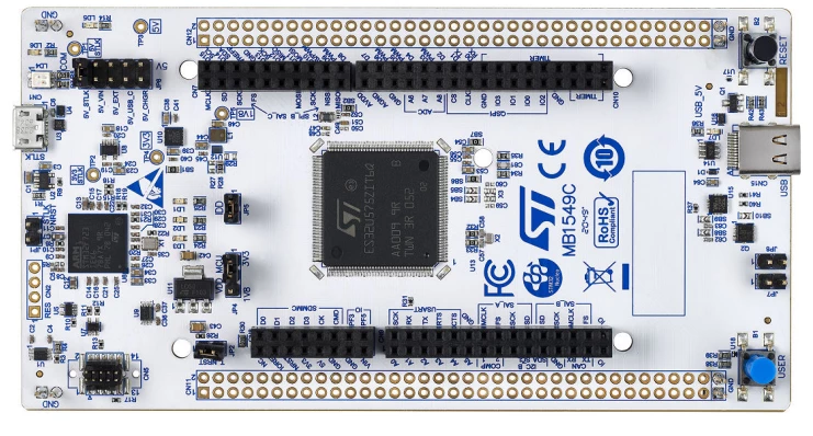

@dish12 wrote:
 an MCU that has ZIO headers
You mean the double-row Arduino headers? Like this:
That's a feature of the board - not the MCU.
They are found only (I think) on the Nucleo-144 boards.

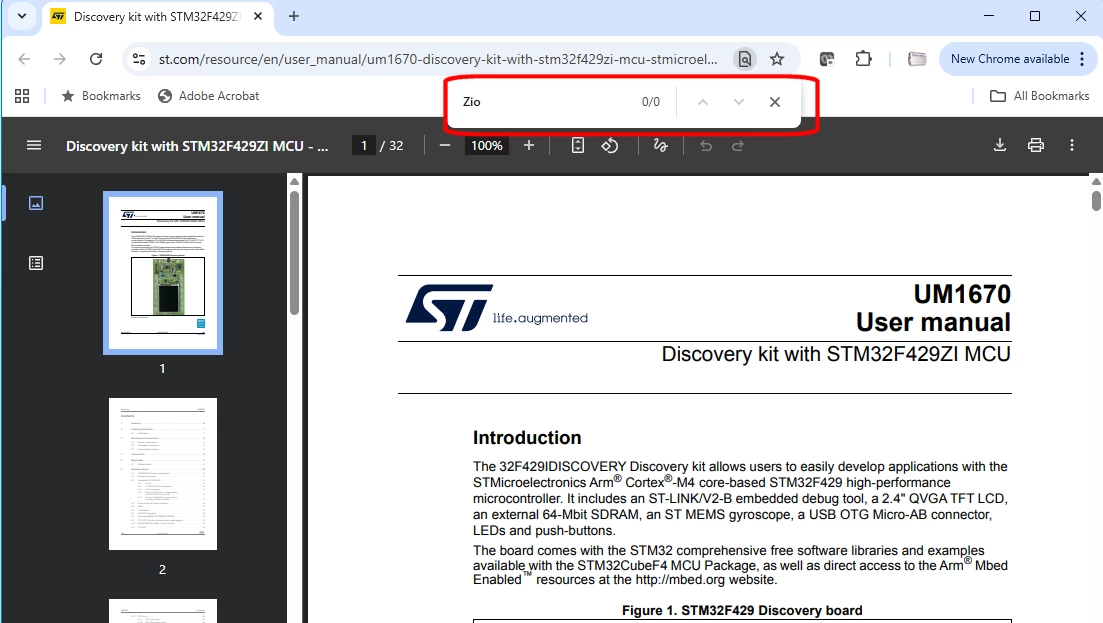

@mƎALLEm wrote:
STM32F429-DISCO board that has ... male ZIO connectors.
Does it?
I thought Zio meant the double-row headers on the Arduino layout ?
That disco just has standard 0.1" two-row headers ?

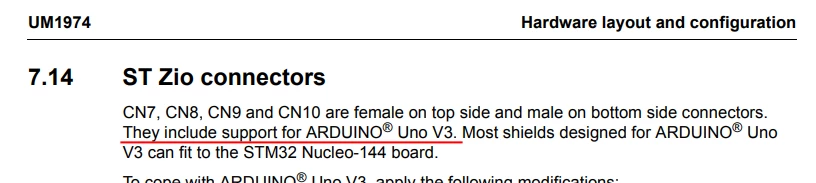

PS:
https://www.st.com/resource/en/user_manual/um1974-stm32-nucleo144-boards-mb1137-stmicroelectronics.pdf#page=37
There is no mention of "Zio" in the STM32F429-DISCO manual:
