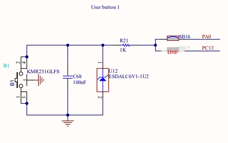

FPicc.1
FPicc.1Author
June 17, 2024
Here's the schematic of BUT1 pin. I'm not sure if the PA0 bypasses this connection, or if would only work if the button is pressed
Tesla DeLorean
Guru
June 17, 2024
Ok, so NUCLEO-WL55JC(1) board
You could remove the solder-bridge (SB16) or link, or move to PC13 (SB15) if nothing else conflicts, and use the EXTI15_9
That would free PA0 for your own, personal use, on the MORPHO connection/headers

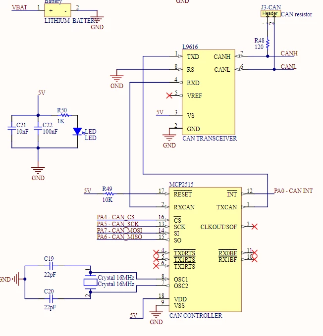

FPicc.1
FPicc.1Author
June 27, 2024
Also don't know, here's the schematic on the board (consider PA0 as PB14 (CAN_INT_Pin))
Senior III
June 27, 2024
So either enable pullups for the stm32 pin or connect pullups.  Datasheet is your best friend for the register programming.  Good luck
