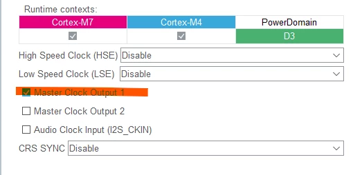

I am trying to write code to enable the MCO1 clock output on pin PA8 on the STM32H755ZIT6U microcontroller, the code is fairly simple.
The code below is my attempt to do so. I couldn't find the problem.
This code activates MCO1 and MCO2 so we can probe the clock frequecy of the STM32 MCU

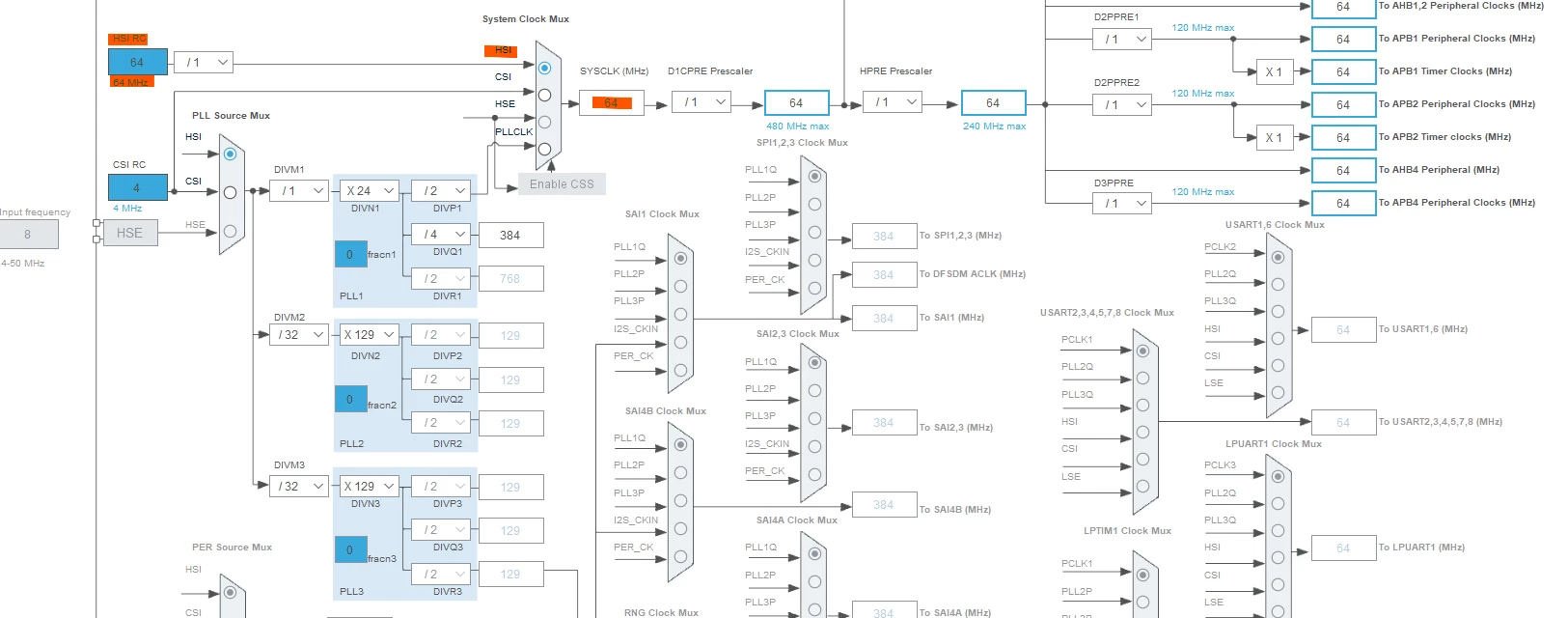

I tested it by configuring the clock tree in CubeMX and it worked, the output is about 4.2MHz, which is what I expected, but I couldn't do the same without the autogenerated code.

Ahlayn @FadiEid and welcome to the ST Community :smiling_face_with_smiling_eyes:.
What i suggest you is to debug step by step the code generated from CubeMX. Then follow which registers are configured in each step. After that, reproduce it using the register programming.
