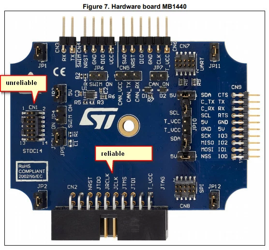

0693W00000APkckQAD.jpgHi All,
Does anyone have the circuit diagram (schematic) for this board?
Basically (and I have posted about this before, without any conclusion) I have several boards which work perfectly (sw download and SWD debug) via the big 20-way CN2, but are unreliable via the little 10-way CN1 (sw download works but SWD always fails within some tens of seconds or minutes).
Buzzing the thing through with a meter, I can verify CN1 and CN2 are interconnected directly, on all the relevant signals, so this difference is a mystery. But maybe CN1 has some funny stuff on it. I see no useful explanation in the PDF
https://www.st.com/resource/en/user_manual/dm00526767-stlinkv3set-debuggerprogrammer-for-stm8-and-stm32-stmicroelectronics.pdf
It may be that JP4, JP5 and others around there made CN1 different to CN2.
The issue is not affected by whether Cube IDE debug (STLINKV3) is set to 24MHz or 8MHz. SWD is set to 2MHz and reducing that makes no difference to reliability either.
Many thanks in advance.

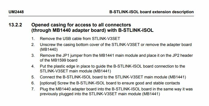

So, if I understand: there is an issue with MB1440 but also another using B-STLINK-ISOL that connected.
If only focus on the use of MB1440 (no V3 ISOL connected), CN1 (STDC14) and CN2 (JTAG20) provides the same signals, all duplicated as a same wire (for JTAG connection). Then there is no reason observing a different behavior whatever using CN1 or CN2 JTAG connections. Then check attentively the used and connected signals in both CN1 or CN2 configurations.
If now consider the addition of the MB1599 (B-STLINK-ISOL) into MB1440 (STLINK-V3 ADAPTER), then the connection cannot be done on the CN2 connector of MB1440 since the supposed purpose is to have the isolation function added.
The connection of the target now should be done on the CN1 connector of MB1599. For this configuration, the jumpers settings must be modified according to section 13.2.2 of UM2448.
This consists in removing the JP1 jumper from the MB1441 and to place it on JP2 header of MB1599. I maybe this is the rootcause.

"then the connection cannot be done on the CN2 connector of MB1440 since the supposed purpose is to have the isolation function added.
The connection of the target now should be done on the CN1 connector of MB1599."
Yes; there is no way around this since the ISOL board covers up all the connectors of the base board :)
I did the JP1 -> JP2 jumper move.
Something strange is still going on. I don't buy the counterfeiting issue because the MB1440 has almost nothing on it and anybody wanting to copy it will work it out in a few hours. I just didn't want to spend a few hours...
I suspect there is something affecting the clock signal. When I get some time I will examine it; I have a 400MHz scope and a 1GHz low-cap probe.
