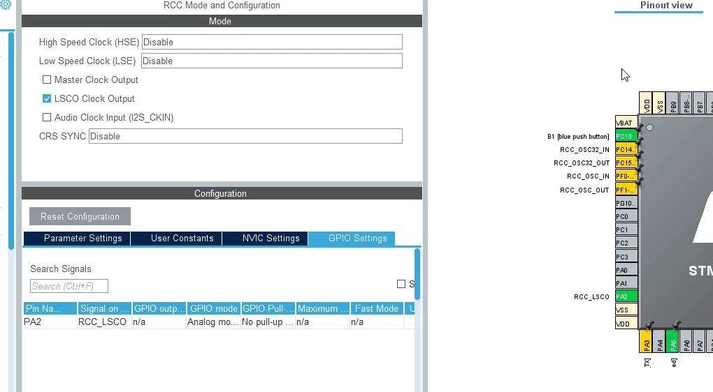

I have tried to route the LSI clock to PA2 pin in my Nucleo Board G474RE without success. SB13 & SB17 are open (it means ST Link is not connected to PA2 pin). Configuration was carried out with STMCube32 Mx but I don´t obtain the CLK in PA2. I have checked also the LSCOSEL and LSCOEN bits and are correct configured.

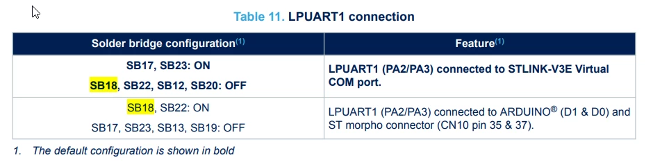

Where are you measuring the PA2 pin? Ensure it's connected in the schematic to the place you're measuring by looking at the schematic. If you're measuring at the header, SB18 needs to be on.

TDK, thank you very much for your answer. You have rigth it was missing to "close" the SB18. Just for the others who could have also the same problem as me I post a screenshot from the UM2505 where it is commented. Thanks again!

I attached a set of files to help (ioc+elf+main.c),
PA2=>LSCO (LSI as input)
PA8=>MCO (LSI)
