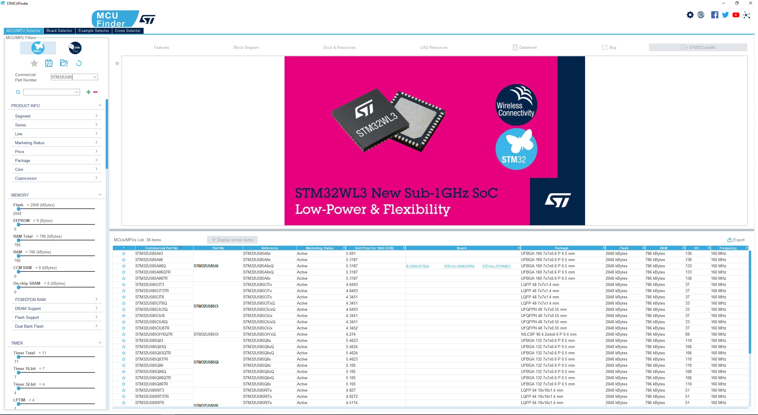

There is not any evaluation board that use the STM32U585OIY MCU. If you want to find any MCU adapted to a board, I suggest you use the ST-MCU-FINDER-PC (or on the Phone version) or the version included in CubeMX so you can find the available MCUs and if there is any board that use this MCU:
