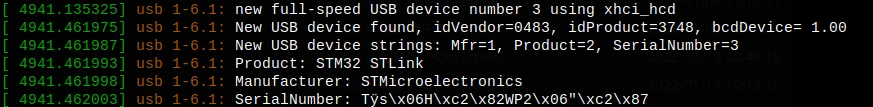

I am trying flash my STM32F746G Discovery board with new code from Linux. I run into this issue after running "dmesg -w": "can't set config #1, error -32". ST-Link is not being detected by either STMCubeIDE and STMCubeProgrammer. Has anyone run into this issue before?

after plug st-link to a usb, you should see on dmesg output:
If nothing - take another cable+port , if on not-just-charger cable no st-link found . its defective.
+ Try on other PC/Labtop...to be sure.
Feb 2, 2025 6:58 PM UTC
I get most of that output, but after the manufacturer details I get  "can't set config #1, error -32". I will try this on a different laptop and get back to you later today.
