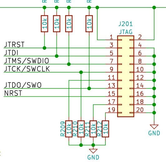

good morning, I wanted to ask a simple question.
I'm drawing the schematic of a small board based on the NUCLEO-F401RE.
I have a doubt about the JTAG/SWI connector, practically on various schemes I have seen that there are pullup/pulldown resistor (see attached) but on the NUCLEO scheme it seems to me that there are not. So the question is: do I need pull-up/pull-down on the JTAG/SWI interface?
Thanks in advance
 FM

I general you don't need Jtag Pull Up/Down. The STM32 Jtag interface has internal pulls.
federico.massimi
January 28, 2019
the SWD interface also have internal pull-up/down ?
in all cases do you advise me to provide pull-ups on the pcb and not to mount the resistances or is it totally useless and I do not even plan them?
