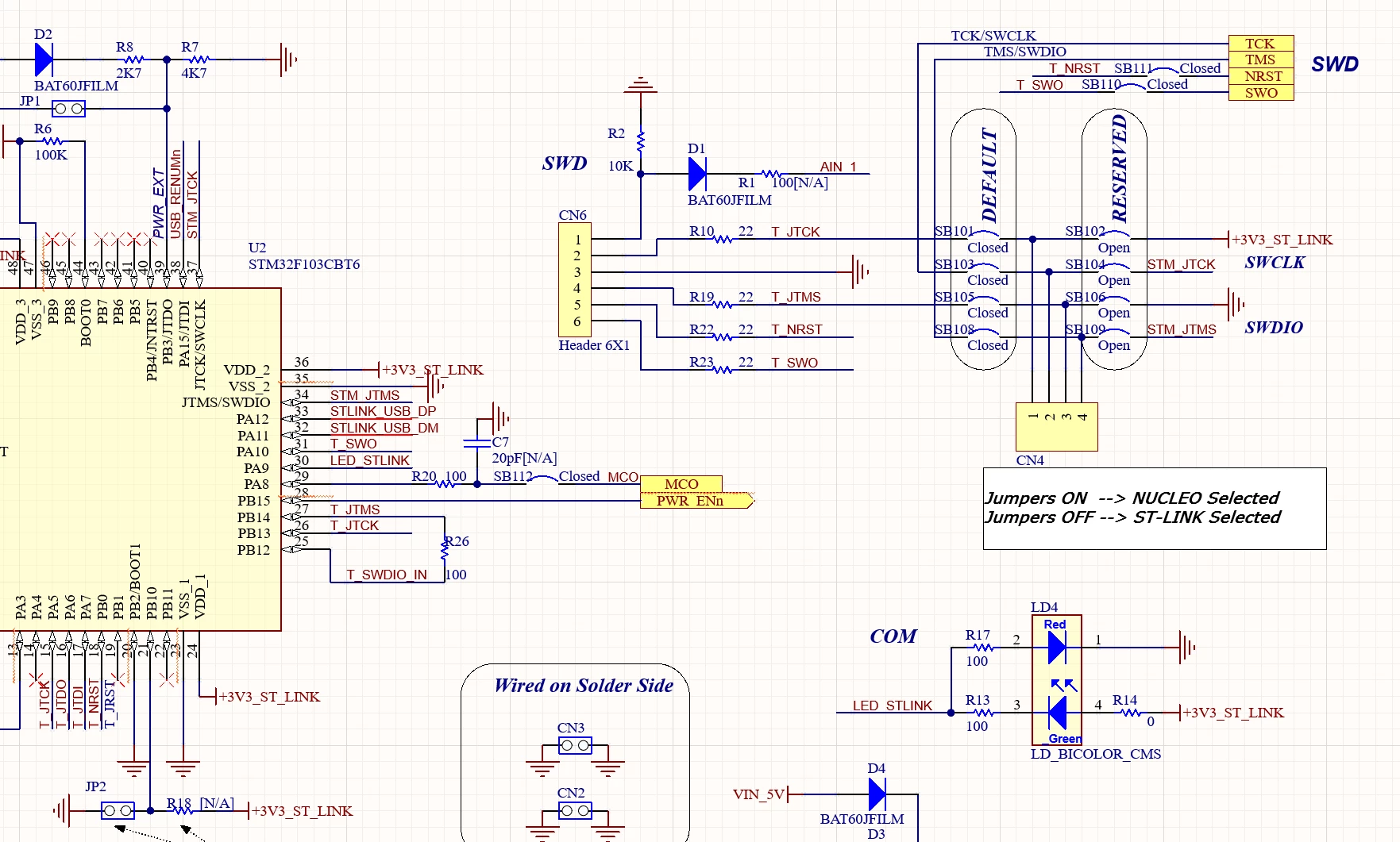

In general this should not be black magic, we've all got some Nucleo boards, which are a great example that programming STM32 with STM32 is possible. On my NucleoF722ZE, the STM32F103CBT6 does the programming. It should receive packets via USB, then program the main MCU via either JTAG or SWD. It has a pair of jumpers - CN4, when closed - the jumper connects T_JTCK with SWCLK, and T_JTMS with SWDIO, and programs the big MCU via SWD interface.
When I look at how these signals are wired, I see this:
PB14 (SPI2_MISO) - T_JTMS - SWDIO
PB13 (SPI2_SCK) - T_JTCK - SWCLK
PB12 (SPI2_NSS) via resistor - T_JTMS - SWDIO
It leads me to think that SWD is done somehow with SPI2 in half-duplex master mode. I've seen people mentioning SPI for JTAG more than once, but I haven't found a good example.
If STM has the code for Nucleo STM32F103CBT6 programmer freely available - that would be everything I need to proceed with my project. But I can't find it.

So it's not like there is no information on the topic. Almost all the code I found seems to bit-bang the data. I find it hard to believe that both JTAG and SWD on all STM32-based programmers are wired to SPI peripheral by pure coincidence :D Especially after that last repo for ESP32, which reads it via SPI.

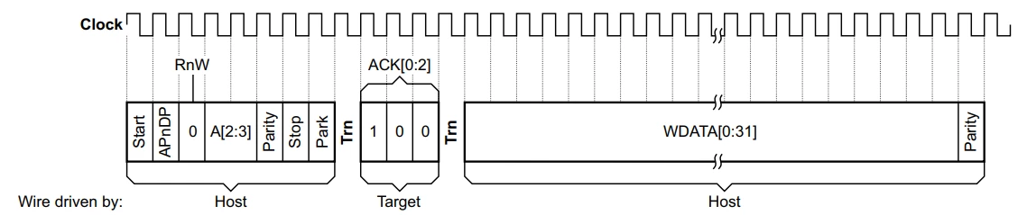

This is a write:
Assuming an 8 bit SPI interface, you send two bytes for the header:
0, 0, 0, Start (1), APnDP, Write (0), A[2:3]
Parity, Stop (0), Park (1), Trn (1), Ack[0:2] (111), Trn (1)
You can now look at the ack bits and if you get the OK response (100), then you proceed with the data write in 5 bytes:
Wdata[0..7]
Wdata[8:15]
Wdata[16:23]
Wdata[24:31]
Parity, 0, 0, 0, 0, 0, 0, 0
If you get the WAIT or FAULT response, handle them as appropriate.
The leading zeros in the first byte and the trailing zeros in the last byte are ignored and are harmless.

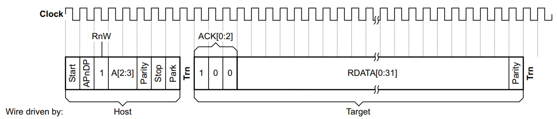

This is a read:
The header is bit shifted one bit later due to not needing a Trn between ack and data:
0, 0, 0, 0, Start (1), APnDP, Write (0), A[2]
A[3], Parity, Stop (0), Park (1), Trn (1), Ack[0:2] (111)
You can now look at the ack bits and if you get the OK response (100), then you proceed with the data read in 5 bytes:
1, 1, 1, 1, 1, 1, 1, 1
Parity, Trn (1), 0, 0, 0, 0, 0
The MISO line will clock in the target read back response while you are clocking out 1.
You don't need to do any bit banging, just clever alignment of SPI bits.  There are some wasted clock edges, you clocked 56 bits to handle a 46 bit transaction, but that's relatively minor overhead to get the benefits of using the SPI peripheral to clock things in without bit banging.
