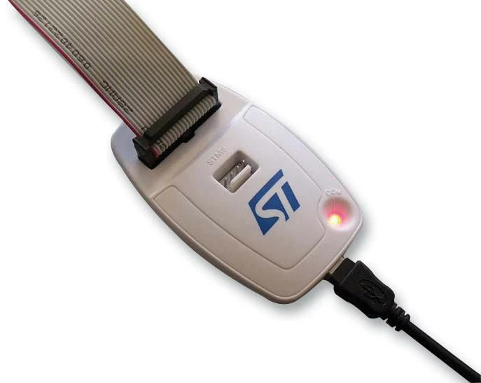

Hii everyone,
I.m using STM32F407G-DISC1 board. I've ST-Link V2 external debugger (which image I've attached) because I don't want to use onboard debugger. I want to do a boundary scan testing. Can you suggest me is there any free tool available for STM32F4 to do boundary scan testing.

STlinks do not expose bare JTAG transactions, to my kownledge. As bare JTAG transactions are needed for Boundary scan so the STLINK can not do Boundary scan.

Can you please suggest any JTAG adapter suitable for stm32 and software also.

Boundary scan is a wide area. Normally you select a boundary scan tool and that tool has support for one or several adapters. Many tools support FTDI based adapters. But your milage may vary!
