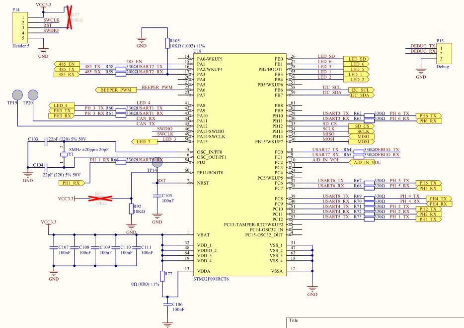

JLINK OR STLINK can`t find stm32f091rct6 .
  • September 1, 2019
  • 1857 views
I used stm32f091rct6 in my project. and used keil5, jlink, and stlink too.
There have one problem that JLINK& STLINK can`t find stm32f091rct6 in my board.
Follow is my SCH, it can`t be found too when I soldered one worked chip that was from NUCLEO-F091RC`s board.
What is there any problem in my HW?

Did you try to connect under reset?
xgao
xgaoAuthor
September 2, 2019
I tried that, but it can`t be found too.
Short reset pin to GND, but the jlink and stlink can`t find chip.
Uwe Bonnes
Chief
September 2, 2019
Reset should be controlled by the debugger. On some devices, Debug does not react under reset.
