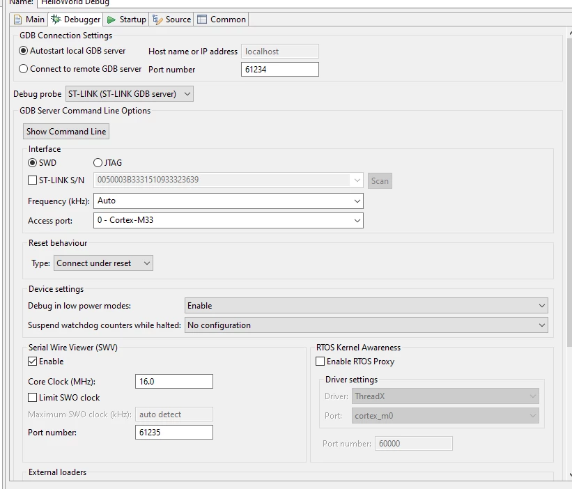

I am just trying to make printF work over SWO. on my board, over STM32 IDE
Board number: NUCLEO-U575ZI-Q
Things i tried on the internet:
1. dont forget \n sign.
2. Make sure you have Solder bridge or whatever, to SWO: Internet provides lots of images of some table, where you have this SWO pin explicitely mentioned and said if its soldered or not. I never found this, but i did look at scheme, and everything related to SWO was present, no DNF

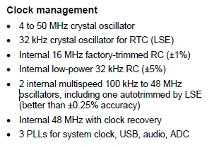

3. You have to have your CoreClock config synchronized: The only thing i found is in this image. I used both 16Mhz and 48 mhz, with no luck
Now, my config looks like this:

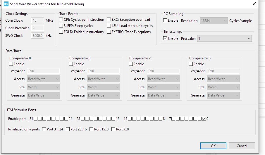

With ITM config like this:
and implementation of ITM function:

https://www.st.com/resource/en/datasheet/stm32u575zi.pdf
"The system clock after wake-up is MSI up to 4 MHz"
So if your code does nothing, and doesn't bring up the HSI, HSE or PLL's, it will be running at 4 MHz

Connection rates for ST-LINK/V2 are typically 4 MHz
Pavel A.
May 13, 2024 9:07 PM UTC
Usually this number must match the value of global variable SystemCoreClock.  For 4.0 MHz SystemCoreClock must be 4000000.
SystemCoreClock will change after your code calls SystemClockConfig() so you want to call SystemClockConfig early, before any printf, and put in the SWV settings box the value after this call.
