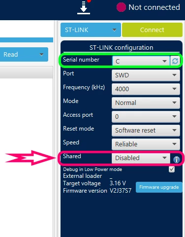

These programmers always show up with a single letter serial number: A, B,C, D.
Using Keil ARM, I can often click around and get them to work (program)
But with STM32CubeIDE and STM32CubeProgrammer they always show up as a single letter and the software refuses to use them.
For instance CubeProgrammer:
Does anyone know the path to resolution for this problem?

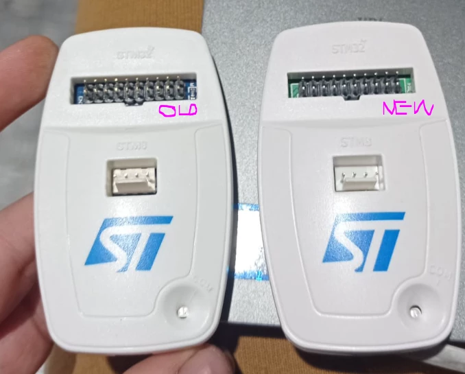

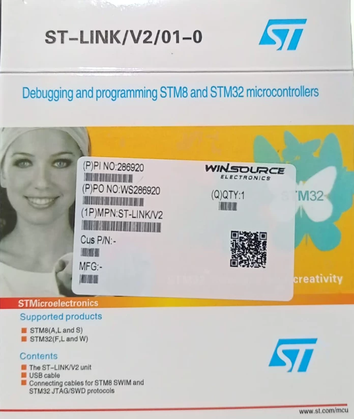

What type are the USB ST-Link programmers?
Can you post an example photo?
Regards
/Peter

Same issue here, the guy from purchasing tought they were original, and they look original to me untill you try to use them:

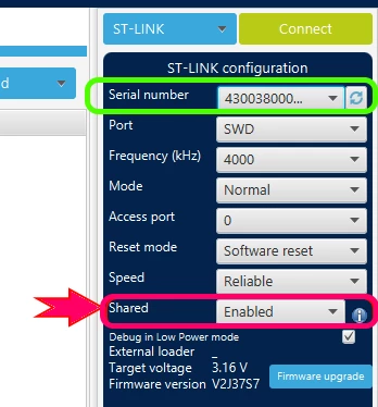

This seems to work for me just enable Shared and click then click the refresh button quite a few times and it'll show a serial number and connect. a little late but i figure it'll help someone out

Thank you, I have the same problem, but the Shared checkbox solved it :)
