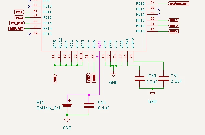

Hello everyone,
I have designed a custom board using the STM32F407VGT6, and I have connected a 3V coin cell battery (CR2032) to the V_BAT pin as shown in the schematic below:
V_BAT Circuit Details:
  • A 3V battery is directly connected to the V_BAT pin.
  • A 0.1µF capacitor (C14) is placed across V_BAT and GND.
  • V_BAT is connected directly to the STM32.
However, I am facing an issue where I do not measure any voltage at the V_BAT pin on my board. It seems like the battery is not supplying power to the backup domain.
  1. Why am I not getting voltage on the V_BAT pin?
  2. Are there any hardware design issues with my schematic?
  3. Is there any special configuration required in firmware to enable the backup domain power?
I have attached my schematic for reference.
A multimeter across the battery should show voltage. If using the ADC, show relevant code. Should be getting something. Nothing wrong with the schematic snippet.

You can refer to the STM32F4G EVAL schematics:
As you can see nothing special:
For the code you can refer to the RTC calendar example here.

You can paste the image directly into the post - where we can see it:
Is the battery dead?
Have you measured to see if current is being drawn from the battery?
I have designed a custom board .
Have you checked the layout for shorts?
Have you checked the assembly for shorts and bad joints?
