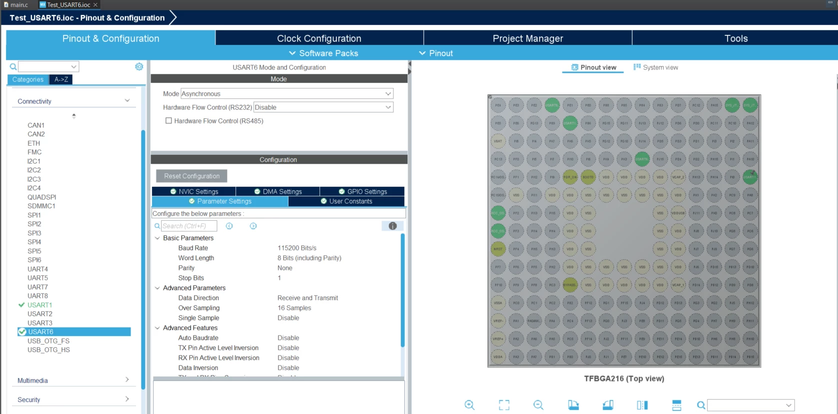

Dear STM Community,
I am currently working on enabling USART6 for data transmission on my STM32F7508-DK board, but I have been unsuccessful so far. I have checked the datasheet for the correct RX and TX pin configurations, and I have tried two different pin combinations:
  1. PG9 for USART6_RX and PG14 for USART6_TX
  2. PC6 for USART6_TX and PC7 for USART6_RX
When I use USART1, everything works perfectly, but I need USART1 for other tasks, so I am planning to use USART6 for terminal output.
Could someone help me or provide a solution to get USART6 working as expected?
Thank you in advance for your assistance.

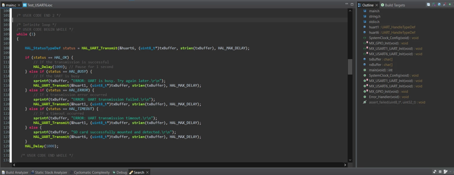

AS5Author
Dec 10, 2024 3:11 PM UTC
Thank you for your response.
I tried to test a simple communication setup to send a message to the terminal. I followed the datasheet to configure the pins, but the USART6 still doesn't work. To debug the issue, I created a small test function that uses USART1 (which I know works reliably) to print potential error messages. This way, I could identify what might be going wrong with USART6.
Attached, you'll find a screenshot of the terminal output and the function I used to diagnose the issue.
Looking forward to your insights!
Andrew Neil
Dec 10, 2024 3:19 PM UTC
So how did you connect your UART to that terminal?
Please see the Posting Tips for how to post source code - not as a screenshot:
https://community.st.com/t5/community-guidelines/how-to-write-your-question-to-maximize-your-chances-to-find-a/ta-p/575228
