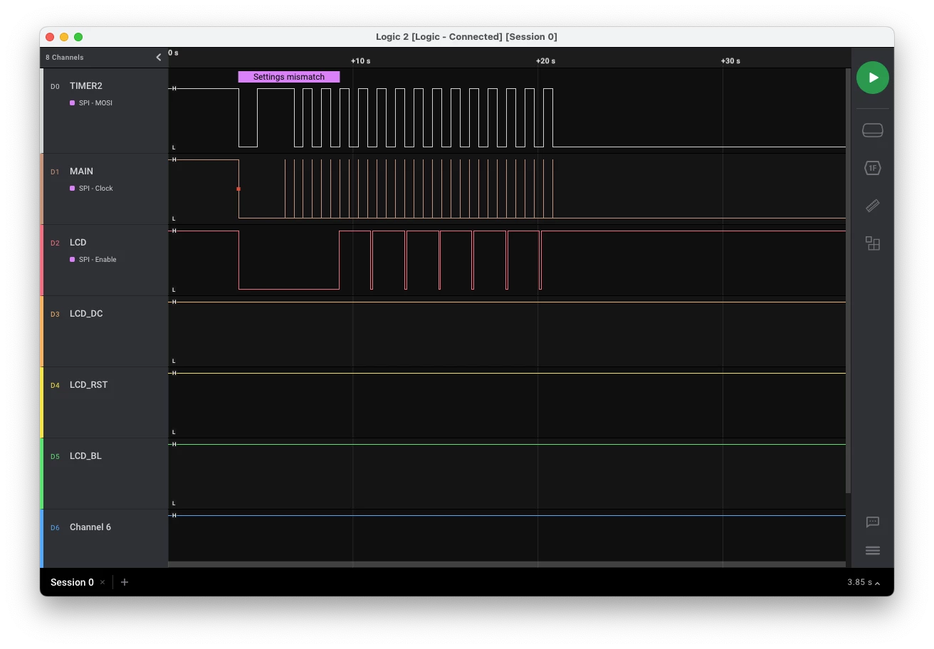

I have attached my project. I am running it on a NUCLEO-F429ZI Board. I am using FreeRtos and LWip
I have 2 threads/Tasks.
The first Task is to initialize LWIP and to read some ADC from DMA
The lcd Task is to display text on a 2" LCD through SPI
I have also added a server TCP/IP initialization through the first task
Everything seems to work until I start communicating with a TCP Client.
After a few communication from the client to the server, all my tasks hangs. (See Logic Plot)

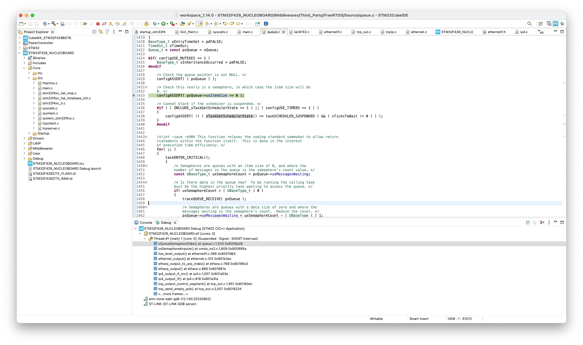

And when I pause the debugger, it seems to be stuck in a semaphoreTake as shown on the screenshot of CUBEIde

I finally found the issue and the ethif thread that is generated in the ethernetif.c was initialized with a stack too low. So I increased it and that solved the issue

So I added a vApplicationStackOverflowHook with option1 and that got triggered.
which means I have a memory setting issue somewhere.
I put a breakpoint in the vApplicationStackOverflowHook routine but I can't figure out how to trace back to know where the issue is coming from.
