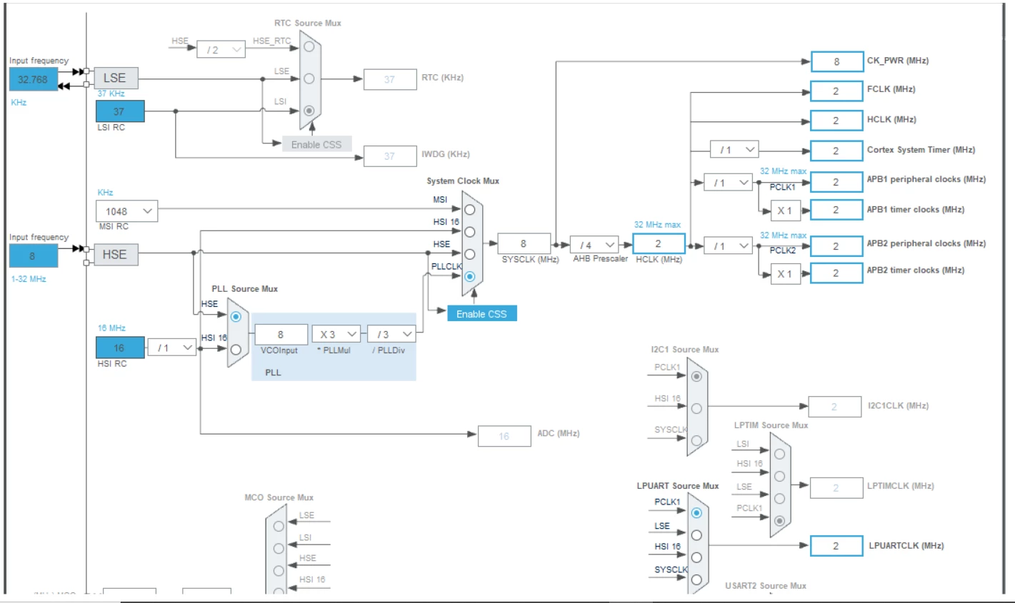

I have a problem in my project involving the STM32L010RB MCU and the HC05 Bluetooth module.
Currently, the system operates smoothly when connected to the USB port. The HC05 Bluetooth module successfully performs its data transmission and reception tasks without any hitches. However, upon introducing an external battery and jumpering pins 2 and 3 on JP5 to provide the Bluetooth module with a 5-volt supply, the module appears to power up correctly, as indicated by the LED, but fails to transmit or receive any data.
I have thoroughly reviewed the connections and power supply, but I have been unable to identify the root cause of this issue.
Best answer by Minaihab
I found the solution to my problem: to start data transmission to or from the Bluetooth module, we should press the reset button on the microcontroller.
However, I have another problem with ADC 2 and ADC 3. One sensor always gives the maximum reading, and the other has no response, while all the other ADCs work. I am using Tim2 and LPUART.

We used LPUART in our project.
Also we used 2 lithium batteries connected in series each 3.7 volts.
