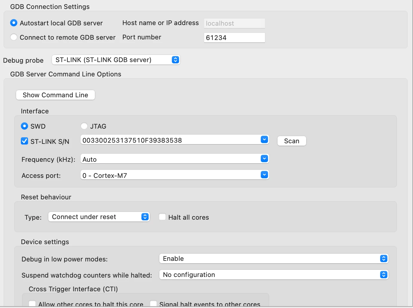

Check the "debugger" options in the "Debug Configuration", and choose the “Scan�? option to use the ST-Link on your board.
I advise you to follow the UM2609 "STM32CubeIDE user guide" (section 3.3) and the AN4989 "STM32 microcontroller debug toolbox" application note (in section 4.2.4)
Please, let me know if this solved your issue.
If this issue is not resolved, please share more details about your environment, version of tools, screenshot of the debug options...

Hi @Imen DAHMEN​ thank you so much for your help.
I was able to get rid of the error I mentioned in the question by unchecking the 'Shared ST-LINK' box in the debugger configurations. However, I'm still getting the program timing out, and not working on the board. I've now added some code to blink one of the user LEDs to confirm that the code is loading. No such luck unfortunately.
After choosing debug as > [my device] the LD4 LED on the nucleo board changes from solid green to flashing red and green. I can't find a guide anywhere on what this means, do you know?

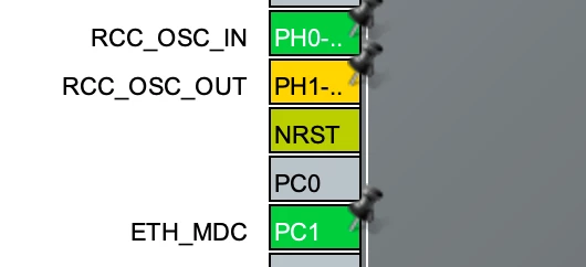

Also, mentioned in AN4989 "In case of problem to connect to the board with STM32CubeIDE, make sure that NRST from ST-LINK is properly connected to STM32 NRST."
I suspect this isn't done correctly. I've included a screenshot from my IDE of the NRST pin.0693W00000FAzIGQA1.pngI've also got a screenshot of my debug configuration currently. Please let me know if anything looks out of place?

Hi @JBori.1​ ,
Please have a look at the following aspects described in this FAQ: Why my STM32 doesn't start?
This may helps you to properly working with your STM32 board.
