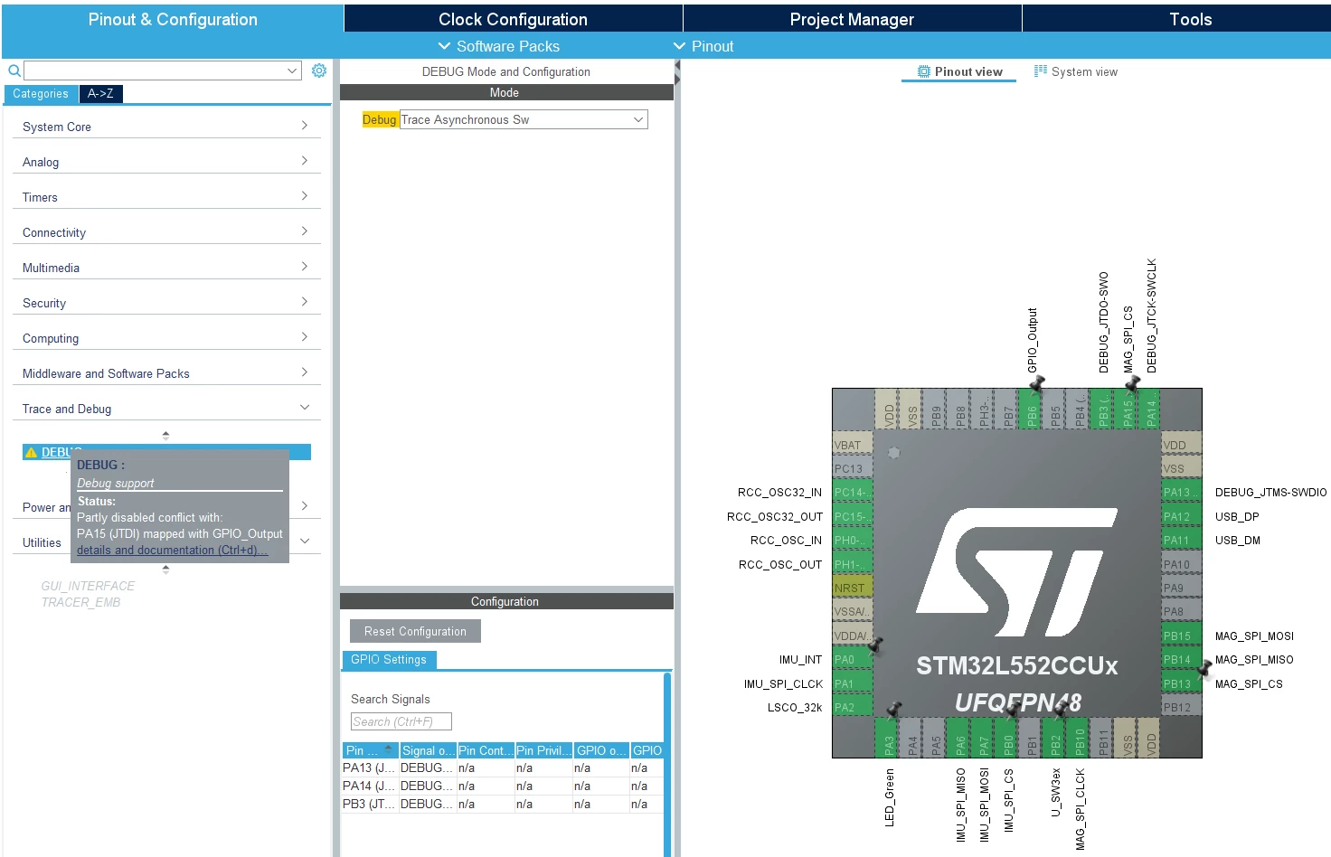

Just to get the details out of the way, I am quite new to STM32CubeIDE. I have a SMT32L552CCUX microcontroller paired up with TDK ICM-42688-V IMU sensor on a custom PCB, this will be my motion sensor device. I am also using STLINK-V3MINIE in-circuit debugger and programmer to deploy the firmware and debug the device.
Debugger settings are all default.
I got PC connected to STLINK-V3MINIE and it's fully updated, its then connected to the pcb (powered on via a different source) via a ribbon cable. If I unplug it and try to debug I get this output:

What is curious though that it does hit a breakpoint in file stm32l5xx_hal_pcd.c at line 1908:
if (ep->doublebuffer != 0U)
If I press continue nothing happens. I am not quite sure what I'm doing wrong. Any help would be highly appreciated.

It should be working with what you are doing.
If connection drops like that, it probably is a hardware thing. Can you share the schematic? Is power rail stable and are decoupling capacitors present?
If you upload a barebones simple code which doesn't modify clock at all, just blinks an LED, does that work?
Andrew Neil
August 2, 2024
Tesla DeLorean
Guru
August 2, 2024
Start with the fact you can't connect.
Does the ST-LINK/V3 have VTarget and GND connected.
Double Check SWDIO/SWCLK connected to the right pins and the orientation of everything is correct.
No connectivity can also mean the MCU isn't viable,most likely not powered, missing VDDA/VSSA
Check NRST level, should normally be HIGH
Provide Schematic of salient sections
Use STM32 Cube Programmer to do this initial connection testing. Check what voltage it reports for VTarget
