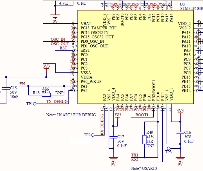

Hi Team,
We are using STM32F103RDT6 MCU, for connecting 5V RS485 transceiver to the MCU. We used (PIN no 16,17) USART2(RX-PA3,TX-PA2)and one GPIO (PIN no 15) pins of MCU. Kindly clarify the below points
1. From the datasheet,it shows all pins are 5V tolerant. Is USART2(PA3,PA2) pins also 5V tolerant?
2. If yes how long it will sustain? Is there any constraints.
Warm regards,
Monisha OM

  1. No. Check Table 5. High-density STM32F103xC/D/E pin definitions. 5V tolerant pins are marked as FT, PA2/PA3 aren't.
  2. There are no constraints, pins that are actually 5V-tolerant can work indefinitely with 5V applied.

0690X00000DYVZRQA5.pngThank you berendi for your response.
Now we are updated our circuit with Pin 29 (PB10-TX1) and Pin 30(PB11-RX1)is used, which is 5V tolerant pin. Please find the image of the circuit.
In the datasheet its shows "For 5V tolerant pin, In order to sustain a voltage higher than VDD+0.3 the internal pull-up/pull-down resistors must be disabled". We are using this UART pins for communicating with RS485 transceiver(5V).
so shall we considered these pins as push pull configuration?

Output pins should be either push-pull if the RS485 transceiver would recognize > 2.8 Volts as high level (check its datasheet), or open-drain with external pull-up resistor when it has a higher threshold. Inputs should have external pull-ups if necessary.
BTW, what are those short circuted resistors R48,R49 supposed to do?
