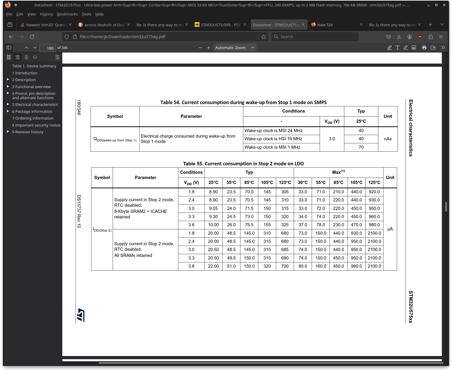

I am having STM32U575ZI-Q development board. I have implemented a firmware with FreeRTOS with low power support where the firmware goes to the low power mode and unless there is an external interrupt, it stays in a low power mode.
Now, I want to measure the current ocnsumption when the MCU goes to the sleep mode (STOP2 mode specifically). Is there anyway I can measure the current from the STM32Cube IDE or any addtional board that can be interfaced with the development board?

Hi @mdalal !
Not possible for you to measure the current from the MCU through jumper JP5 with a DMM?

mdalalAuthor
Dec 16, 2024 10:02 AM UTC
Oh, do you mean that if I connect the DMM across this jumper pins, the job is done? What precision of DMM is required.

Dec 16, 2024 10:26 AM UTC
@mdalal wrote:
I am assuming that the DMM is in current measurement mode.
Yes, of course.
Yes. The precision of the DMM depends on your requirements. Personally I would prefer a DMM with you can at least measure 1µA.
The possible power consumption from the MCU in different situations are also described in the device datasheet.  Here is a screenshot:
