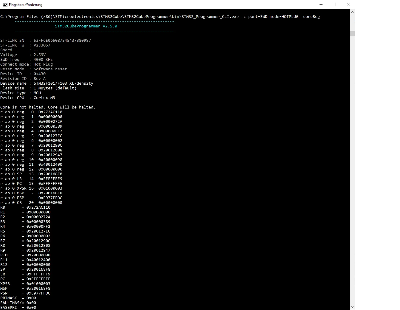

Is there a possibility to read program counter via ST-Link or J-Link without causing a reset on STM32F103 devices with RDP active?

On a serial product after a firmware update, there are some sporadic cases, where we get a hang up situation. It would be very helpful to know where exactly the program is stuck. According to ES0346 Rev. 6 chapter 2.8 it is possible to access program counter even with RDP set. How can I exactly read the value with CubeProgrammer + ST-Link (or alternatively with J-Link).

Thank you for your reply, I tried to use the CUBE programmer with command line interface instead of gdb, as this seemed to be the easier way with the call STM32_Programmer_CLI.exe -c port=SWD HOTPLUG -coreReg
which should do the same. But I allways get a PC value of 0xFFFFFFFE, even if I connect a device running in normal programm execution. Perhaps I will try the gdb-server.

I will do these things, but as a first step, I would like to find out, where exactly the code hangs. So I tried to get the program counter with:
STM32_Programmer_CLI.exe -c port=SWD mode=HOTPLUG -coreReg PC
this gives the register values, and other values like SP make sense, but PC is always FFFFFFFE?!
Do you have some hint how to really get the PC?

Uwe Bonnes
Chief
October 28, 2020
The picture stille says "Software reset". Reset would destroy PC.
stst9185
stst9185Author
October 29, 2020
Thanks for the tip, I didn´t recognize this first. I still wonder why there seems to be a reset although the mode setting is HOTPLUG.
