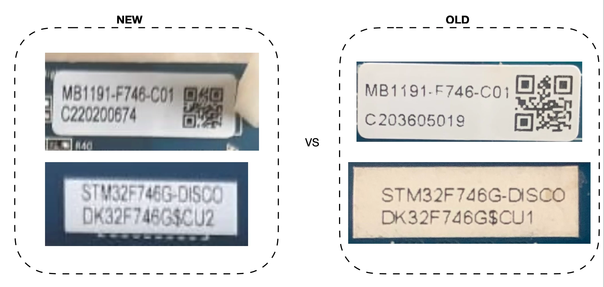

SKhol
SKholAuthor
August 22, 2022
Dear All,
I tried changing solder bridges by making below connecytions
SB1 PB8- SHORT
SB3 PF6 (OPEN)
SB4 PB9 - SHORT
SB5 PF7 (OPEN)
Still no luck. The test firmware still not working with new board & its perfectly working with old board.
For more information, I am attaching comparison of marking labels on New Vs Old DISCO board.
Please suggest
Tesla DeLorean
Guru
August 27, 2022
They both claim to be C01 revision boards
Expect you'll need to debug the code, understand the specific issues there, and then relate those to the circuit as you trace it out, and compare to the schematic

SKhol
SKholAuthor
August 28, 2022
If I flash the same firmware in 2 boards ( 1 new , 1 old ) and test one by one, old one works and new board doesn't so its obvious that only change is the new board
Tesla DeLorean
Guru
August 28, 2022
Could be a component or BOM level issue.
H​owever "not working" is hard to diagnose without more specific detail.
Don't you have the source, can't you debug or instrument to focus on the specific reason for failure?
