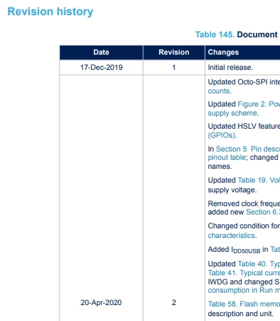

your board is not "old" , but the audio codec is ...not the most recent. :)
see ds:
So codec was new in 2006 , last revision 2020. But thats no problem, my old Sony CD player is 30 y old and still working fine. So the year of design for an audio codec is not a problem, audio hasnt changed the last 35 years.

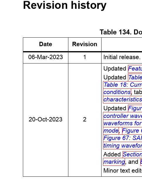

And the H7B3 cpu ...
4 years ago you could order it first time, do you think , thats "old" ?
IF you want something very "new" , take a H563 board :
From last year, and you get all problems of a new cpu :

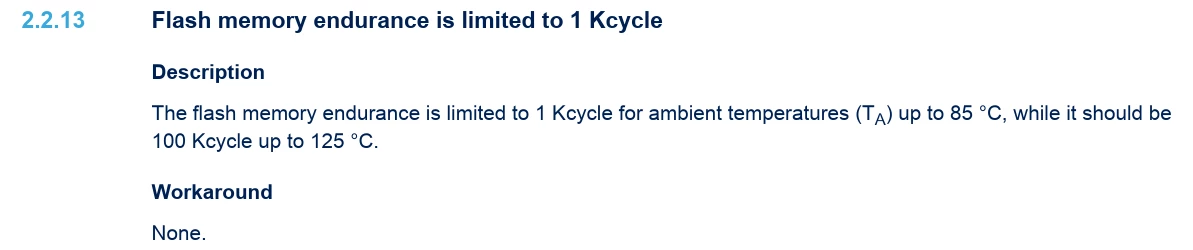

my board has a revision Z chip , that has a lot of curious problems, like :
So can start debug 1000 times - then need a new cpu . Thats really new - right ?
