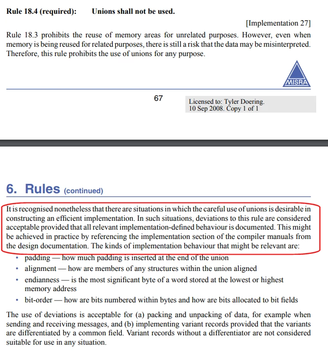

All in the title.
I'm asking this question because I have compilation warning inside a library that I included in my project. And inside the source-code of this library, there is a mention about rules of C MISRA-2004 that are not respected.
Here is the mention :
/** \page CMSIS_MISRA_Exceptions  MISRA-C:2004 Compliance Exceptions
  CMSIS violates the following MISRA-C:2004 rules:
   \li Required Rule 8.5, object/function definition in header file.<br>
     Function definitions in header files are used to allow 'inlining'.
   \li Required Rule 18.4, declaration of union type or object of union type: '{...}'.<br>
     Unions are used for effective representation of core registers.
   \li Advisory Rule 19.7, Function-like macro defined.<br>
     Function-like macros are used to allow more efficient code.
The warning concern an union (like Rule 18.4 that is not respected).

Andrew Neil
April 5, 2024
Have you actually read the MISRA document?
So the notes you've seen in the CMSIS Library comments are just fulfilling that requirement to document this deviation from the Rule.
This is acceptable.

Andrew Neil
April 5, 2024
@q3z85d41xqz036d wrote:
But that doesnt really answer my question : is stm32cubeIDE use C MISRA 2004 Compliance ?
Yes, it does answer the question about MISRA compliance - it meets the compliance criteria of documenting what it does.
I dont know why I get a warning from the struct I provided (from the source-code).
Where does that warning come from? It looks like just a compiler warning?
Compiler warnings are nothing to do with MISRA compliance.
