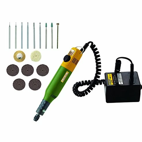

Is nucleo_l152re a two layer (or more) PCB design?
Posted on December 14, 2017 at 18:57
I see there some have problems (the board doesn't work well anymore) after separating the programmer part from the rest of the board. And I intend to use this tool to cut the bridges...
#pcb #cut #bridges
