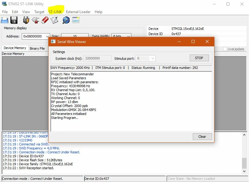

Is it possible to show SWO trace from cli with ST-LINK_CLI or some other tool?
  • May 7, 2019
  • 1344 views
I'm using ST-LINK_CLI to flash my STM32F427 and I'd like to start SWO tracing after flashing. Is there a (Windows) command line tool which can do this? Currently running Win7, ST-LINK CLI v3.4.0.0 and ST Link  FW: V2J33S7

Vangelis Fortounas
May 7, 2019
Hi.
STLink utility supports trace view with fixed freq 2MHz.
PB3 pin must be connected to SWO pin of STinkV2.(plus all the others for SWD)
