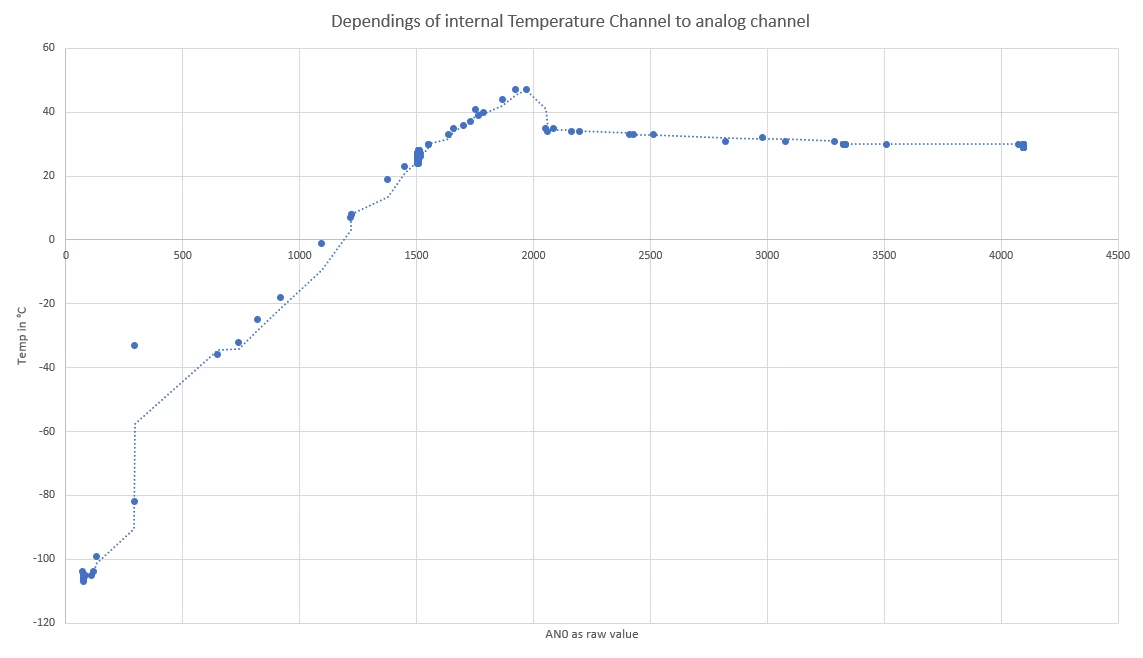

I'm measuring Channel AN11 (Pin PB10) and the internal Temperature of the CPU of my STM32G071RB Nucleoboard via DMA. DMA is necessary, because later on the project will scale a lot. I really hope, someone has a good solution for this.
When changing the voltage on AN11, the internal Temperature Value also changes. Here Some Examples:
Raw Value of AN11Converted Temperature of CPU in °C
70-104
74-106
819-25
144923
192447
217034
328831
4001/ 409530

August 11, 2023
Dear @Patsch36,
Considering the variation of CPU temperature and your external measurements, it seems that you are using the external conversion result to compute the internal CPU temperature.
Can you please check by converting the internal TEMP_SENSOR only while keeping variation on your external sensor?
Best Regards,
Gwénolé
Patsch36Author
August 11, 2023
That's what I do. I convert the second value of the dma and send the first value only as reference (Take a look at the last code lines I provided). When turning my potentiometer from left to right, the value of AN0 changes from about 10 to 4095. I think that's the right value, so the other one must be the temperature value.
I also tried different pins for the external signal but all of them have the same result. I hardly doubt that my CPU has a temperature of -100°C :D
GwenoleBBest answer
August 11, 2023
The sampling time of the internal temperature sensor is probably too short!
You must wait at least a minimum of 5µs. Can you please verify this point?
Best Regards,
Gwénolé
