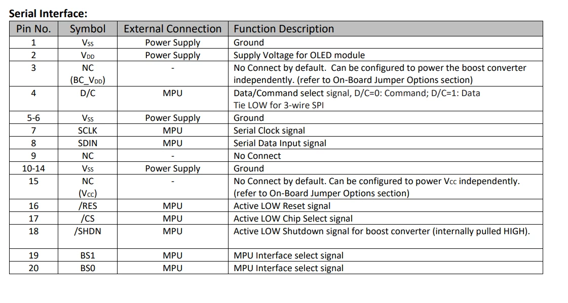

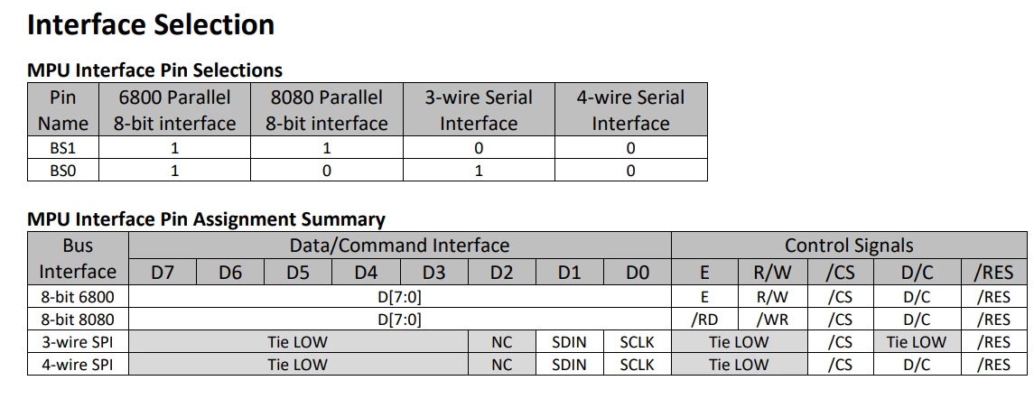

I am doing 3 wire SPI Communication, So i have connected all 20 PINS as follows:
Pin1 ---> GND
Pin2 ---> 3V
Pin3 ---> NC (No connection)
Pin4 ---> PD9 (DC; GPIO_Output, assigned by cubeide)
Pin5 ---> GND
Pin6 ---> GND
Pin7 ---> PA5 (SCLK; SPI1_SCK, assigned by coubide)
Pin8 ---> PA7 (SDIN; SPI1_MOSI, assigned by coubide)
Pin9 ---> NC (No connection)
Pin10 ---> GND
Pin11 ---> GND
Pin12 ---> GND
Pin13 ---> GND
Pin14 ---> GND
Pin15 ---> NC (No connection)
Pin16 ---> PB12 (RES; GPIO_Output, assigned by cubeide)
Pin17 ---> PB13 (CS; GPIO_Output, assigned by cubeide)
Pin18 ---> PB14 (SHDN; GPIO_Output, assigned by cubeide)
Pin19 ---> PB15 (BS1; GPIO_Output, assigned by cubeide)
Pin20 ---> PD8 (BS0; GPIO_Output, assigned by cubeide)

With quick review, looks that you have comment out spi transmission from ssd1322_hw_spi_send_byte- function ?
I would probably first double check signals and levels on the display connector with oscilloscope to make sure spi signals are working and also other display pin are in correct states.

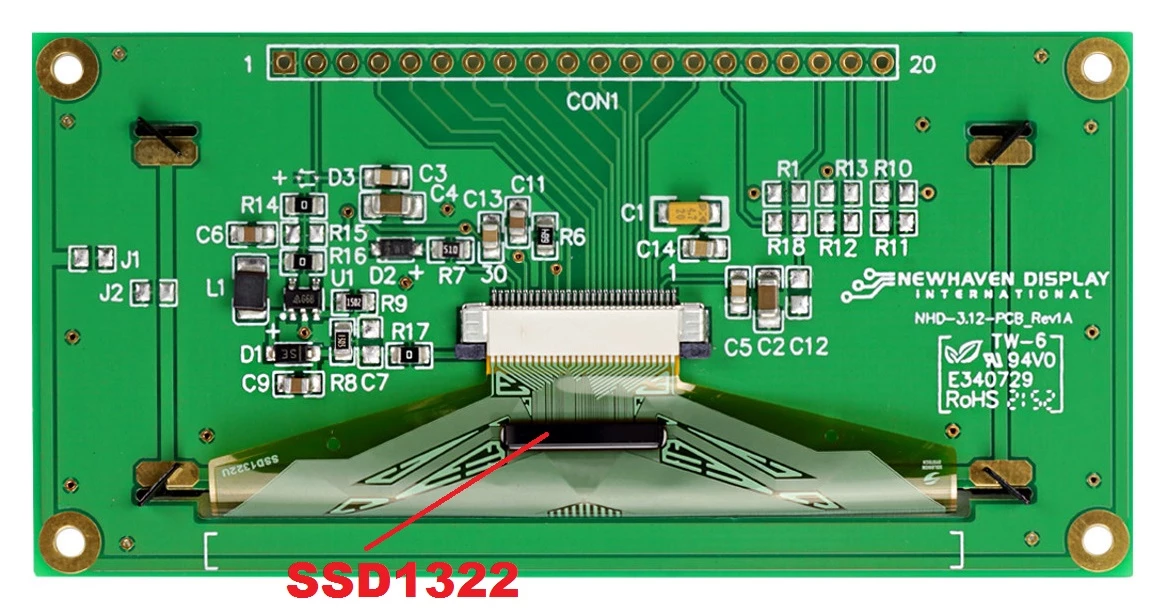

Sir, i have some questions. NHD 3.12 25664 and SSD1322 both are same display? actually i am trying on STM32F411 with NHD 3.12. Please help me and guide me!!
Tesla DeLorean
Guru
May 25, 2024 6:18 PM UTC
The NHD 3.12 25664 uses an SSD1322. It's usually a bare IC mounted on the flex cable, converting the MCU Interface into pixel drivers for the display in a rows and columns fashion.
