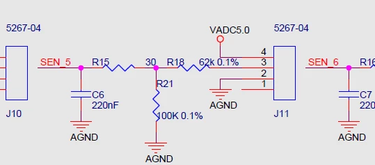

The adc input hardware configuration of the stm32h743 board I made is shown in the picture below.
0693W00000UnbhZQAR.png​
I know that there is a big input impedance problem because I omitted opamp by mistake.
In addition, due to the 16-bit adc error, a large capacitor of 220 nf was attached to the adc input terminal.
Could this hardware configuration that I configured cause interference between adc channels?
