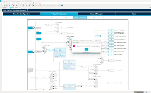

To improve the execution time of a program being run on the board 'Nucleo-439ZI' from the current 20 ms period to less than 1 ms [more than 20 times reduction]. To reduce the same, I tried to switch the clock frequency source of the timer to HSE (8 MHz) instead of the internal clock (32.768KHz) [That means 24 times higher frequency to improve system latency ]. However, some issues are observed when tried by clicking 'Resolve Clock Issues' could not be resolved.
How can I improve execution time from 20ms to 1 ms?

Hello @KumarTP
Would you share your IOC file in .text format? or maybe a screenshot of your clock tree would be sufficient.

Please find the below screenshots
64 KB of 113 KB
mƎALLEm
February 7, 2024
Screenshots not clear.. Please share better image resolution.

mƎALLEm
February 7, 2024
Meanwhile, I need to check internally if this constraint on min HCLK value makes sense and it is not a bug in CubeMx

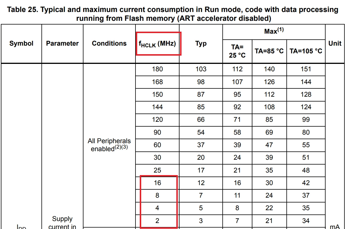

Hi guys,
Normally and at least the MCU could start with HSI which is 16Mhz. To me 25MHz as minimum does not make sense. So it smells a bug in CubeMx.
Moreover in the datasheet in Table 25. "Typical and maximum current consumption in Run mode" 2MHz is there.
I'm raising the behavior internally to confirm the bug and fix it. I will come back to you for any feedback.

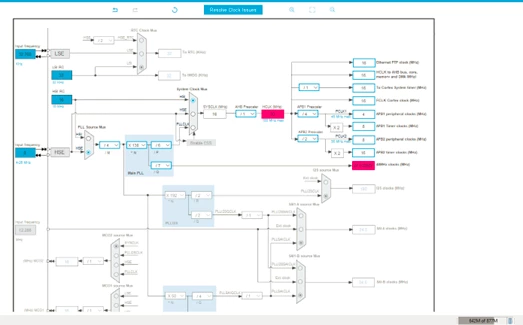

Suspect the threshold instead relates to some other peripheral, perhaps clocked independently from 48 MHz, like USB, SDIO or CRYP
mƎALLEm
February 7, 2024
@Tesla DeLorean @waclawek.jan ,
Yes indeed .. I didn't notice that USB and ETH were enabled in the ioc file.
Thank you guys for pointing me this out :folded_hands:
@KumarTP You need to disable USB and ETH in your ioc file to reach lower frequencies, as these peripherals need at least 25MHz for HCLK to work correctly.

Yes but, in the middle of the discussion he raised an issue when he switches to HSE (@8MHz) which is related to min HCLK clock.

Again the pictures you are sharing have poor resolutions we can't see what is going on. If you can't please share again the ioc file showing these warnings.
Please share readable images.
Also you can click on the boxes in RED to show the warning(s).
KumarTPAuthor
February 8, 2024
Please find the clk settings.
