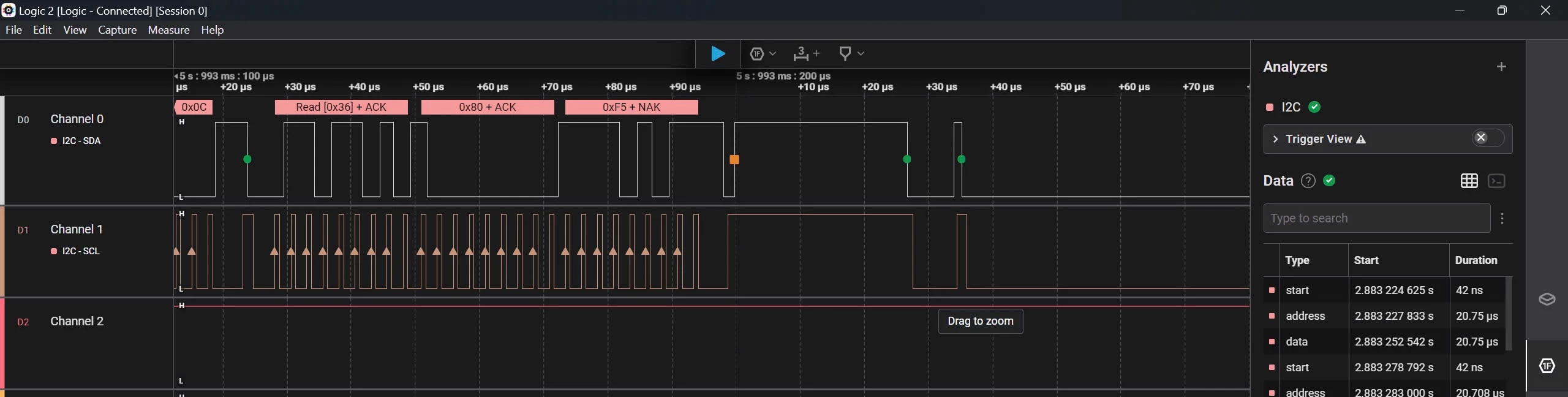

I2C weird behavior, SDA come high before SCL
I was implementing i2c on the stm32f4 to read the as5600 magnetic encoder. Everything ran perfectly for a while, then the I2C got stuck, I check and see that after the start generate, sda transition when the scl still low. I checked many times and the same thing happened every time.

Where you see "wrong" signal?
For me it looks ok.

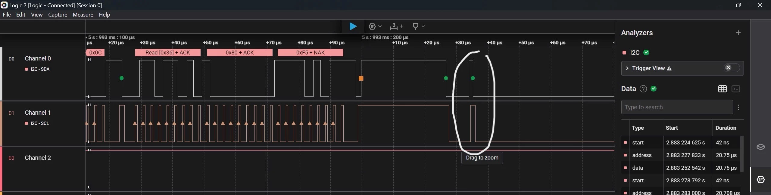

NoNamedAuthor
September 14, 2024
ah yes my bad,
right after generated start, the sda somehow changed before the scl.
AScha.3
September 14, 2024
Ok, this looks ... like an error.  One clock pulse, then nothing...
1. What you doing there ? (command call ?)
2. Did you check for errors ? (state of I2S registers ?)
