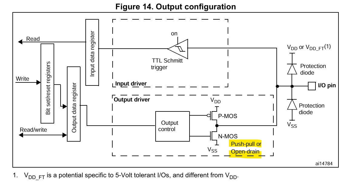

I want an I2C Scanner program for STM32F103C8T6 Blue Pill board. i will use external pullup for the i2c clock and data, because the voltage of the devices i am going to scan is 1.8V. The software should find the address of all the devices connected in the bus and return the address to the pc through UART port. default three i2c ports are not true open drain so i need alternate solution.
Why do you think that?
Pins can certainly be configured in open drain mode, as referenced many times in the RM.

/* USER CODE BEGIN MX_GPIO_Init_2 */
	/* Configure I2C GPIO pins: PB6 (I2C1_SCL) and PB7 (I2C1_SDA) */
	GPIO_InitStruct.Pin = GPIO_PIN_6 | GPIO_PIN_7;
	GPIO_InitStruct.Mode = GPIO_MODE_AF_OD; // Open-drain mode
	GPIO_InitStruct.Pull = GPIO_NOPULL; // Use pull-up resistors
	GPIO_InitStruct.Speed = GPIO_SPEED_FREQ_HIGH; // High speed
	HAL_GPIO_Init(GPIOB, &GPIO_InitStruct);
/* USER CODE END MX_GPIO_Init_2 */
I modified the pin as open drain, i used logic analyzer to measure the siganal but it is automatically pulled up.
July 25, 2024
I don't understand why this is an issue. SDA/SCL should be idle high.

July 25, 2024
If you power your cpu with 1.8v, this looks OK, else you may need level shifter to detect 1.8v signals.
