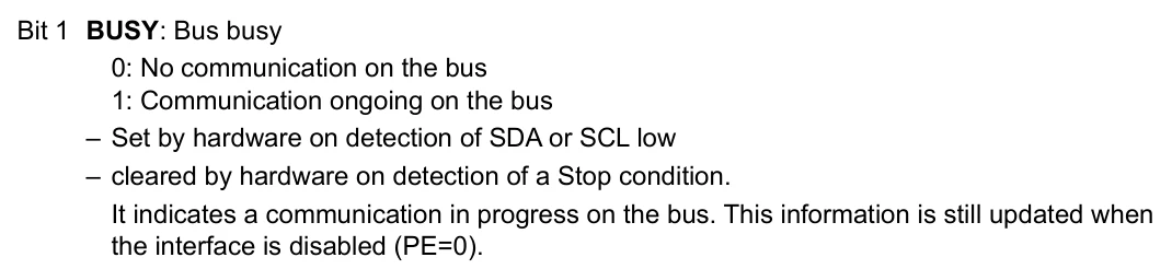

The only issue is that whenever I try communicating with it the function returns HAL_BUSY every time (using both IT and normal modes).
I know there's already a lot of posts talking about the issue but I don't seem to be able to solve it. I am using a pullup resistor for each line and when "idling" both are logic level HIGH which it's correct if I'm not mistaken. When trying to send data from the MCU my oscilloscope doesn't pick up any signal. I connected the peripheriial to the morpho headers and of course in the code is I2C1.image_2024-09-19_131011655.png

What exactly is returning HAL_BUSY?
If HAL_I2C_IsDeviceReady returns HAL_BUSY, it means the BUSY bit is set, which means SDA or SCL is low. This indicates a hardware issue of some kind.

Both the transmit and IsDeviceReady returned busy, however the both the SDA and SCL were high.
In the end I was able to send master to slave data with the blocking function. I moved the bit shifting phase at the declaration of the address since I also saw I was often forgetting it. If tomorrow I'll be able to implement the interrupts successefully I'll mark this thread as solved and make an update post showing what I did.
