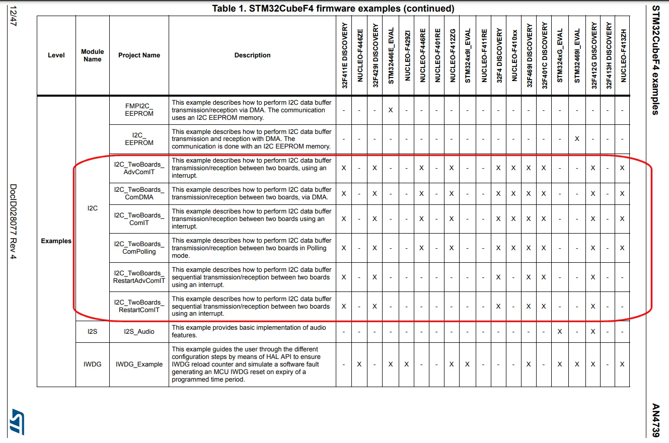

Hi, I am trying to use a Nucleo-F446re as master and another one as slave. But the master is probably being timed out (not sure). Can you guys please have a look at my code and configuration. Thanks in advance <3
My Wiring:
1. I connected PB8 & PB9 of both master and slave via direct wire as I used then as SCL and SDA
2. Connected GND of master and slave
My code:

Have you tried any of the provided I2C examples:
https://www.st.com/resource/en/application_note/an4739-stm32cube-firmware-examples-for-stm32f4-series-stmicroelectronics.pdf#page=12
https://github.com/STMicroelectronics/STM32CubeF4/tree/master/Projects/STM32446E-Nucleo/Examples/I2C

Asif17rAuthor
February 5, 2025
Thank you for those samples. I am new, I have not tried those samples yet. I will try now.

 I actually solved the problem. The examples helped me a lot. Thank you.
