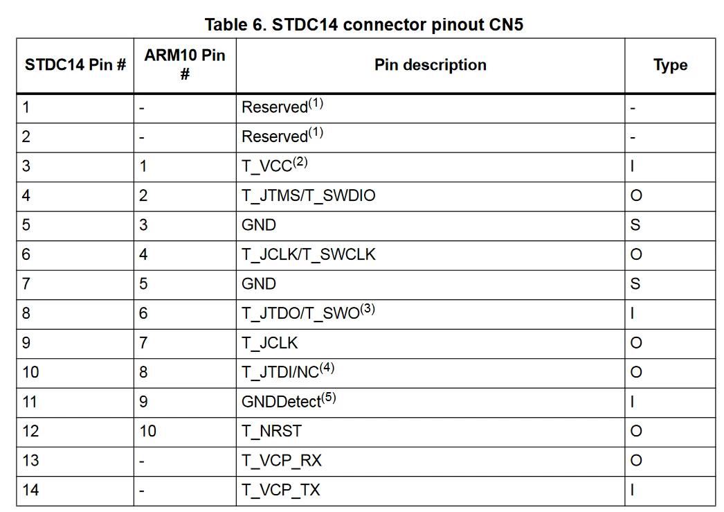

Thankyou everyone for the kind replies,I'll narrow things down,these are the connections for the STDC14 for STLINK-V3MINI,I wanted to ask which pins are actually going to be used for programming/debugging the stm32h7 chip ,for example in stm32f1 i could use the pins from 4 to 7 to program it ,Is it the same for stm32h7,Im sorry if this is not a reasonable question but im just trying to keep it simple,I could have bought the V3SET but Im also on a budget ,plus I also found out that you could debug/program external stm32 with the dev board .0693W000003PE1UQAW.png
August 13, 2020
For debugging with SWD, you absolutely need the SWDIO, SWCLK and GND pins. Optional but recommended would be NRST, SWO, and VCC.
The VCP_RX/TX are useful if you want to use a UART stream for debugging.
