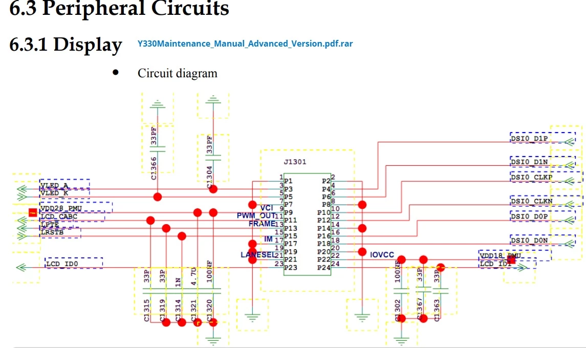

    About the display.
    I could find the cheapest option of the available 4 inches on Ali Express. This means that you may be able to find a cheaper offer. In any case, it does not make sense to use exotic options. It is necessary to use what is available in large quantities. Documentation on the display, as well as its modes of operation - all this can be found in the public domain. In the picture there are tips.
