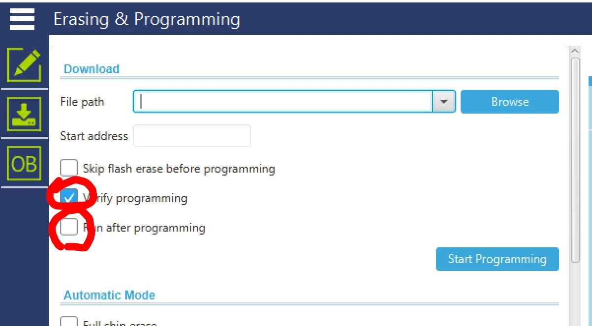

i try to flash STM32F746BG using cube programmer and ST-link V3 MINI debugger, when i click on Start flashing option the It shows download complete. But really it is not downloaded on the device. but its successful when using automatic mode. Why?
i try to flash STM32F746BG using cube programmer and ST-link V3 MINI debugger, when i click on Start flashing option the It shows download complete. But really it is not downloaded on the device. So i go up with Start Automatic Mode option. It is successfully flashed. But when i use Normal start flashing it is not working. If anyone can explain why this happens?

How do you know it isn't downloaded? Use the verify option to verify flashing was successful.

1.i have flashed a simple program for setting PH12 pin as High. So when i used "Start Programming" option, it showed download complete. But still the GPIO is not became HIGH. But when i used "Start Automatic Mode" option, the GPIO became HIGH. That's how i said Flashing is working only with Automatic mode.
2.Where is the verify option located?
August 3, 2021
Are you resetting the chip after downloading code?
There are a variety of ways to verify. Here is one of them. It sounds like you also want to run the program afterwards.

Yes. I am resetting(Power OFF and ON) after downloading code.
Whenever i select Verify programming, it shows that 'verification failed'. But the downloading is completed.

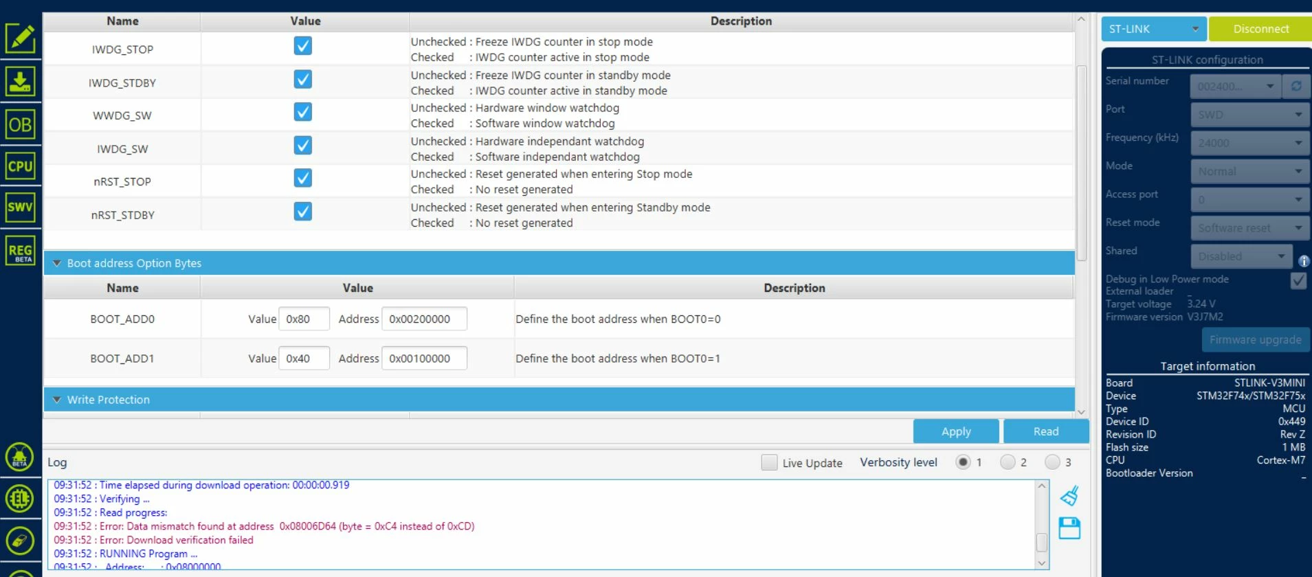

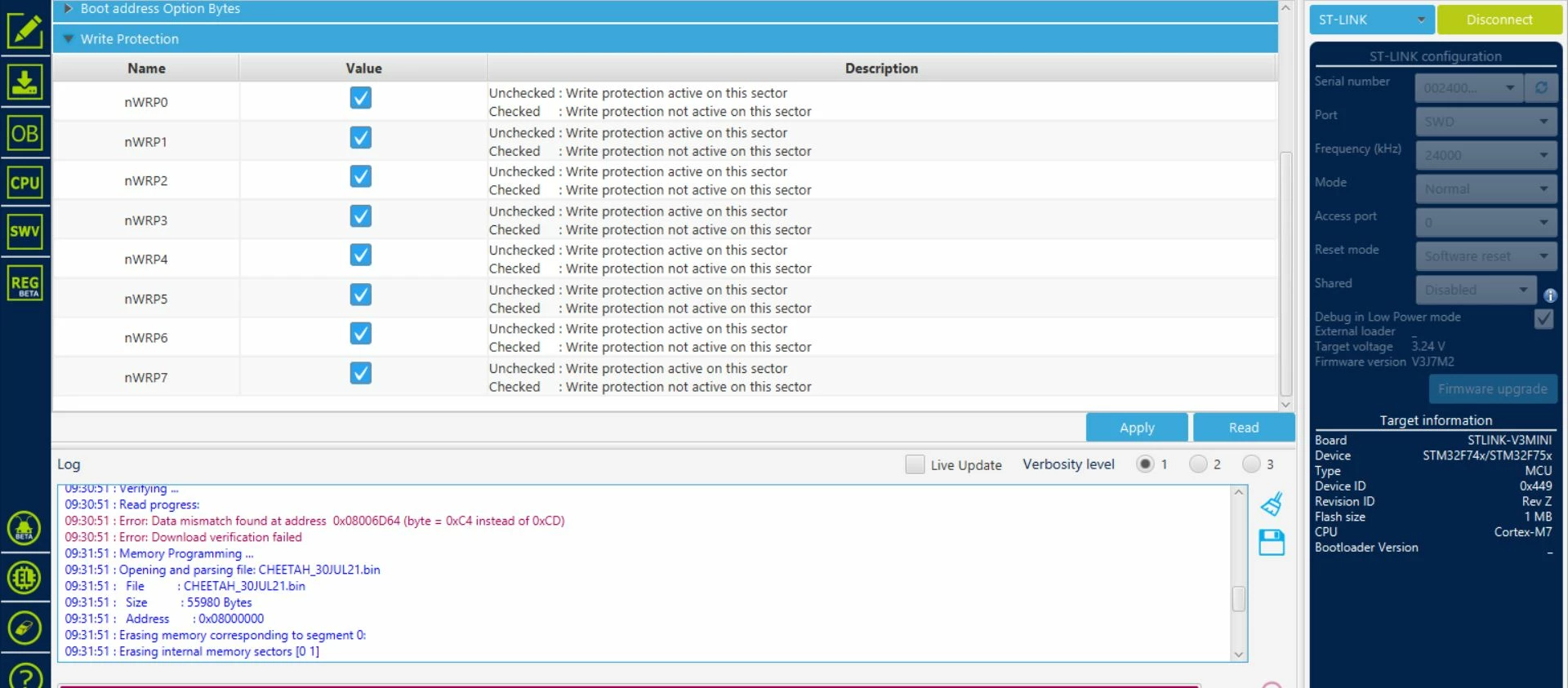

Check relevant option bytes which could be preventing it from writing. Show the log.

log when i selected ' verify programming':

 09:30:51 : Error: Data mismatch found at address 0x08006D64 (byte = 0xC4 instead of 0xCD)
 09:30:51 : Error: Download verification failed

how to check the option bytes are relevant or not?
will you please help me to know more about option bytes?.

0693W00000D1aUkQAJ.jpg0693W00000D1aUfQAJ.jpgwhat should be the option byte boot address?
August 10, 2021
Not real sure. Try doing a full chip erase and verify the contents of the flash starting at 0x08000000 are all 0xFF.
The "Data mismatch" error certainly shows it's not writing what you intend.
Are any other relevant option bytes set that would prevent writing? Is secure protection off? Is RDP reported as level 0?
