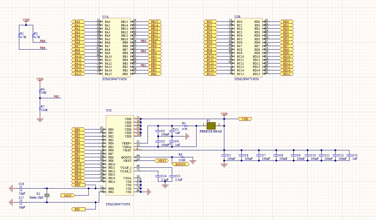

I made a PCB board with STM32F407VGT6 (MCU) + STM32F103CBT6 (Debugger). I get the message ''Usb device not recognizable''. Any idea why?

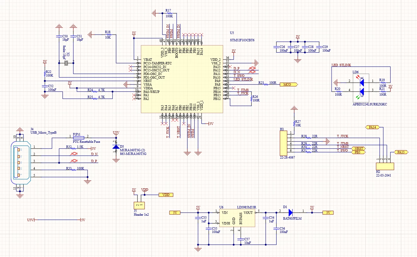

Hi all, I made a PCB board with STM32F407VGT6 (MCU) + STM32F103CBT6 (Debugger). I get the message ''Usb device not recognizable'' when I try to connect it to my computer via USB. I include the pics of my schematic. I followed the schematic of STM32F407G-DISC1

Does the STM32F103 have ST-Link firmware on it?
You're also going to have issues with MCO trying to drive a crystal, unless you don't load some components.

Just to take some things out of the equation, I read the correct voltages on all of the relevant pins.
I haven't loaded any firmware to the STM32F103 but how am I supposed to do that if the device is not recogized?
Can you please elaborate what do you mean by ''load some components''?
Do you think my schematic is correct in terms of wiring the controllers?

I think this has a fundamental flaw. The STM32F103 on the Discovery board has ST-Link loaded. Yours does not. ST-Link is a proprietary code, so you probably don't have access to it to be able to load anyway.
You load data onto the STM32F103 the same way you program any other chip. Typically through the ST-Link SWD interface, or a bootloader. Possibly through the DFU USB bootloader.
I didn't study it, but your 8MHz MCO output from ST-Link is driving a 8MHz crystal. Crystals shouldn't be driven this way. You should choose if you want the ST-Link 8 MHz output as the clock source, or the 8MHz crystal. Can't do both. You can fix this by either not loading the 100ohm resistor, or not loaded the crystal.

ok I took this crystal arrangement from the schematic of STM32F407G-DISC1 which is official. By ''load the resistor'' you mean to apply 3.3V to the R23 resistor?
April 29, 2020
I mean not load the physical resistor on the board. This would sever the connection between MCO and your other chip.

So I tried to bypass STM32F103CBT6. I used the STlink V2 to program the main controller STM32F407VGT6 via SWD and it works fine, this is good news.
At the moment I have no clue how to program the STM32F103CBT6 on my board with the ST link firmware. If I find a way I will share it here

April 30, 2020
One option is to harvest a chip that already has the firmware from a nucleo or similar board or something.

According to them: ''Making your own ST-LINK V2 from STM32 Blue-Pill or STM32 Black-Pill'' I need to attach Tx and Rx pins of my usb to uart cable to the Tx and Rx of the chip and load a specific hex file. Unfortunately the Tx and Rx pins of my chip are not exposed so it's going to be a challenge..

Drive BOOT0 of the F103 high and see if it connects in DFU mode, ie "STM32 in DFU Mode" type reporting in Device Manager.
If you have ST-LINK firmware in DFU form, you could use the DFU tools, or STM32 Cube Programmer to push in that firmware.

Hi all,
I found the solution for loading the ST link firmware to STM32F103CBT6. I downloaded the STM flash loader demo. I connected the Rx Tx pins of a usb to uart cable to the Tx Rx pins (pin 30, pin31) of STM32F103CBT6 and set the Boot0 pin to high (3.3V) as clive1 said. I run the STM flash loader and uploaded the .hex file that can be found in ''Making your own ST-LINK V2 from STM32 Blue-Pill or STM32 Black-Pill'' that contains the firmware.
I can confirm that it works fine.
