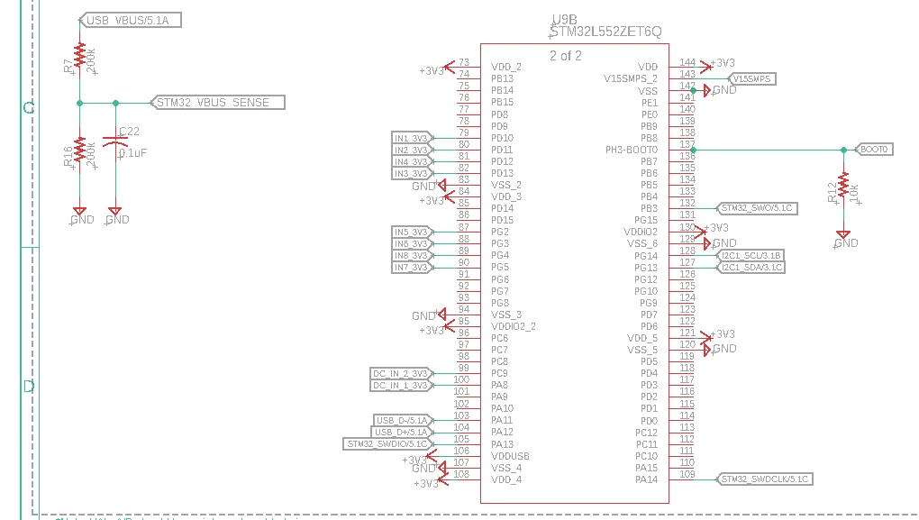

I'm trying to connect to a custom PCB made using an STM32L552ZET6Q using SWD and Cube Programmer, but I keep getting the "No STM32 target found!" error.

I've gone over the hardware with a multimeter and all the pins have the right continuity, I've checked the design against the Nucleo-144 L552ZET6Q schematic and it checks out so far, and I've also checked the connections to the ST-LINK/V3 pins I'm using.
I haven't been able to program the MCU once yet via SWD or USB (I'm mostly sticking with SWD for now).

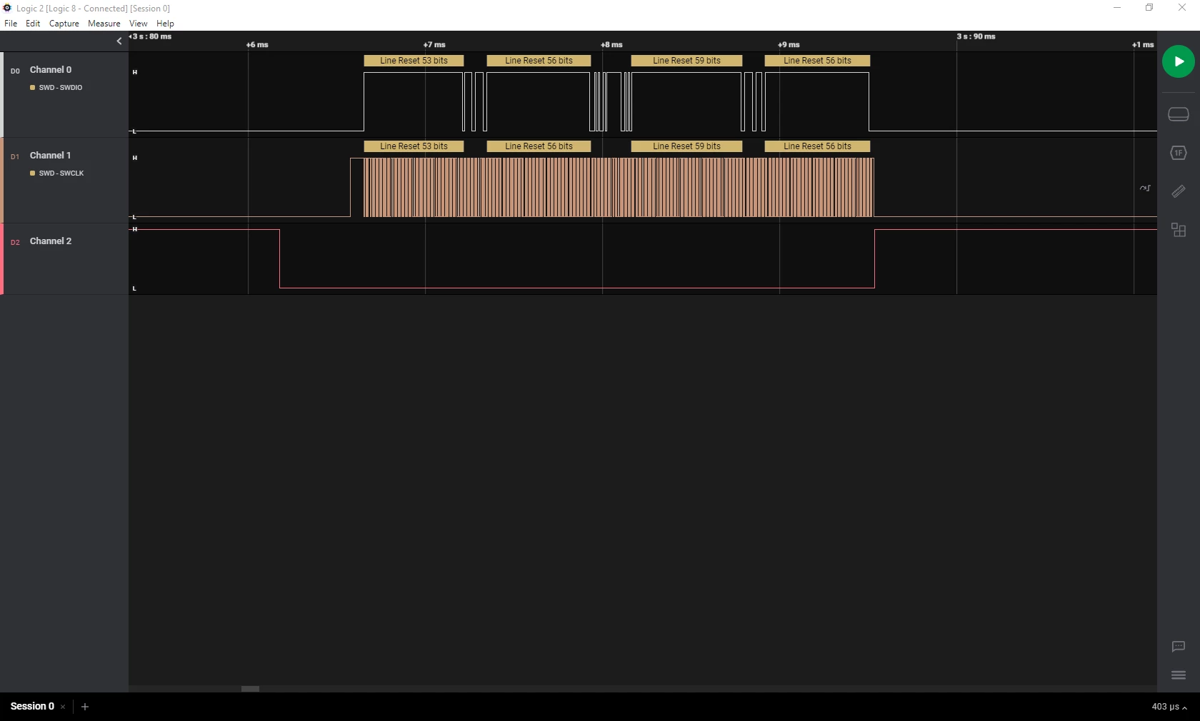

As for NRST, I checked it with a logic analyzer and got this back. It looks like its working to me, at least in terms of the NRST line.0693W00000Svpa1QAB.pngI'll see what else I can find.

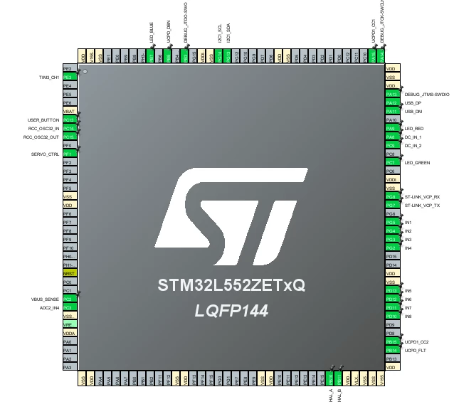

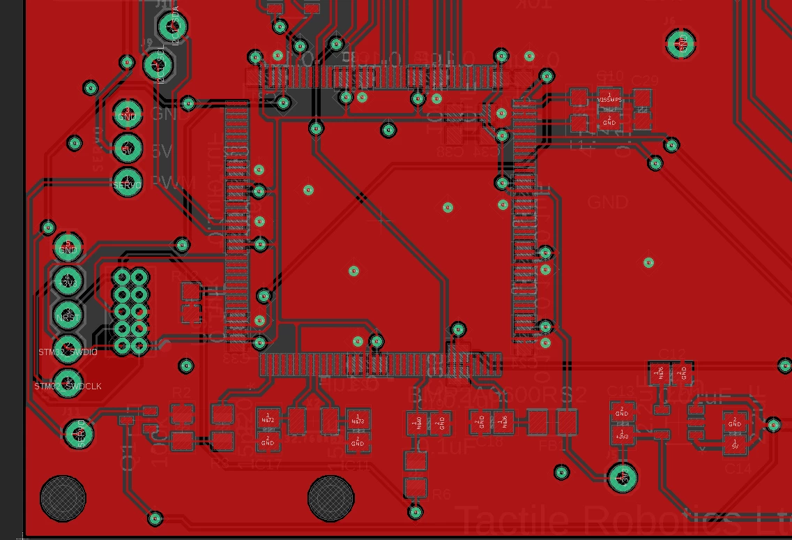

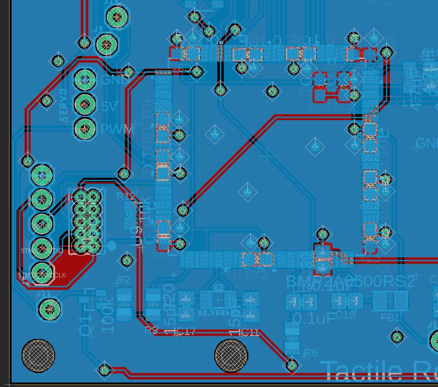

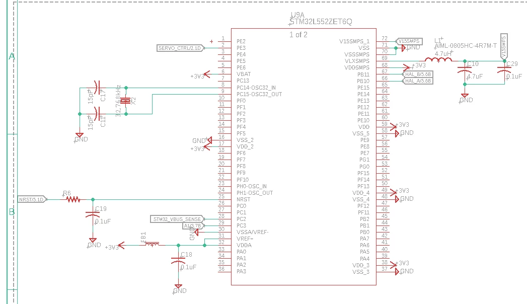

No, it's not getting finger-burning hot. As for the layout, here's the layout regarding the microcontroller (Board and schematic) as well as the MX layout.0693W00000SvuowQAB.png0693W00000SvupVQAR.png0693W00000SvupuQAB.png0693W00000SvuqnQAB.png0693W00000SvurgQAB.png

I realize that the brd file image is a bit much and I'll get a better one. In the meantime, the bottom-left corner is pin 1, then it continues right.

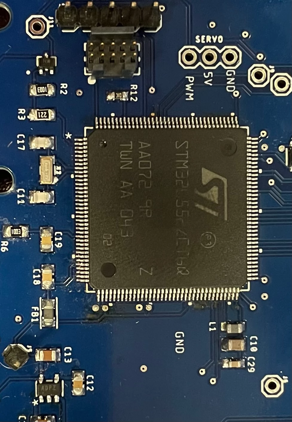

Can you get a picture of the PCB section with the part on it?
Schematic looks reasonable enough, SWD traces look Ok.

0693W00000SvvavQAB.jpgWill do. In the meantime though, I might have found something. There's an 100k ohm resistor between the NRST pin, and the rest of the SWD connection. The SWD side of the resistor is being pulled low, but is it possible that the MCU side of it is still being held high by the internal pull-up? It looks that way based on the multimeter I'm using, but it could just as easily be too slow to pick it up.
Edit: Here's the photo you asked about. The resistor I mentioned is R6
