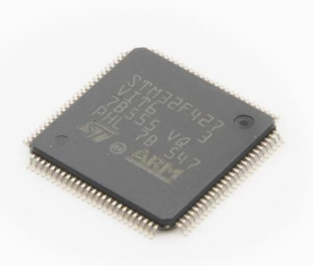

I bought this microcontroller from Ali express I try programming but it is not working
MohamadAlmonakel
November 3, 2021
this is a picture for the microcontrollers
Tesla DeLorean
Guru
November 3, 2021
The markings look to be consistent with those used by ST

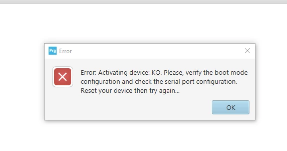

So is the part not programming, or your code not working?
What exactly is something like STM32 Cube Programmer reporting when it connects with the devices?
MohamadAlmonakel
November 3, 2021
I have another microcontroller from another supplier everything is working well

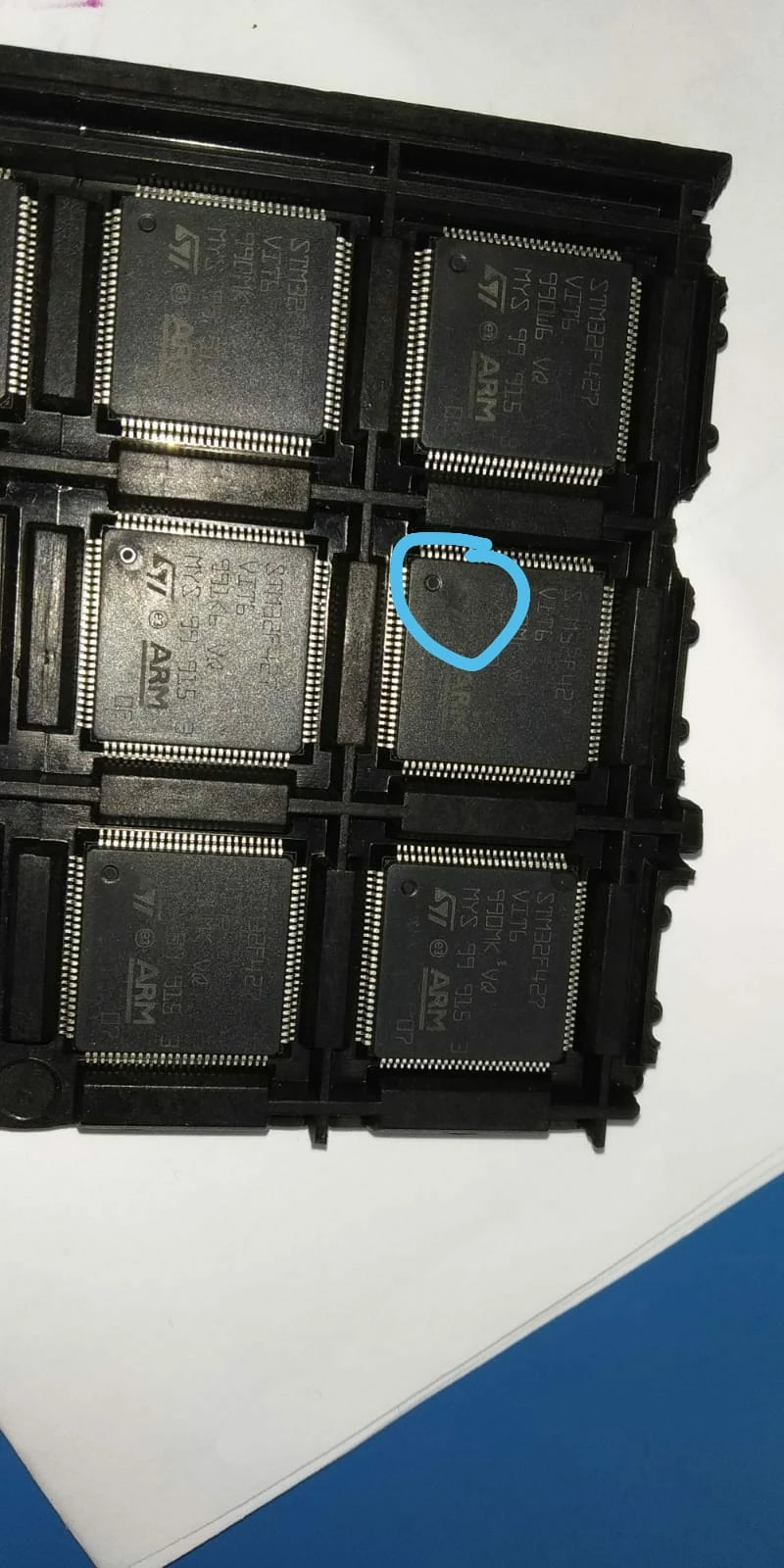

MohamadAlmonakel
November 3, 2021
November 3, 2021
Not looking good so far.
The pin 1 marking has never been an ejection mark on any chips that I've seen. It should be a circle indent, with the ejection mark 180 degrees away. Like this:
It's also exceedingly unlikely that a random supplier on Ali express has stock, but nobody else does. Still possible, I suppose.
Although marking can be inconsistent.
https://community.st.com/s/question/0D50X00009XkhjE/stm32f407vgt6-molding-mark-or-pin-1
