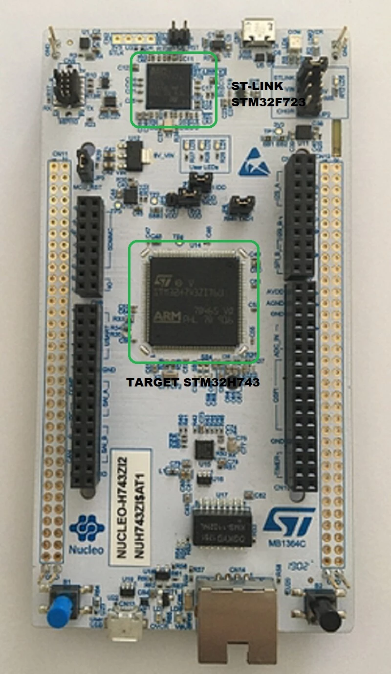

I have a stlink v3set. mcu are stm32f723iek6. To me it is not possible to select mcu target. Can you give to me an idea how to select apropriate target?

Reposting the same information doesn't advance the conversation.
Perhaps show STM32 Cube Programmer connecting with the ST-LINK/V3SET, and the STM32F723 MCU on *YOUR* board.
Are you talking about the STM32F723IEK6 that provides the ST-LINK functionality? Don't expect to be programming that.

STLINK_V3SET is only connected to my Laptop.
I am trying to prepare some program to switch on/of LED
connected to GPIO on CN9 of MB1440.

You don't program the IC on the ST-LINK/V3SET, it is an intermediary connection with an STM32 Target on your own board
PC -> ST-LINK -> TARGET STM32
If you want a board with the debugger, and a target chip, look at the NUCLEO or DISCO boards.

+ what is target cpu ? v3+mb1440 is just programmmer+adapter .
