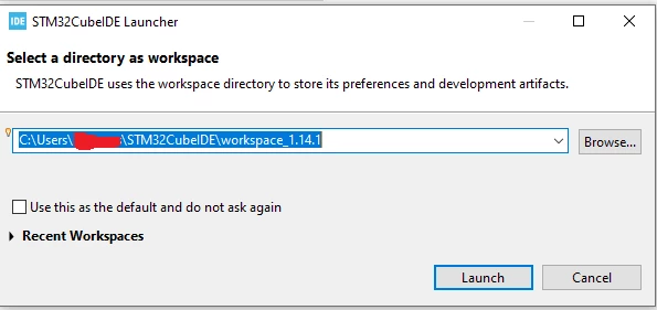

Go to STM32CubeIDE folder and double click on .project file.
This window will be shown, click "Launch" button:

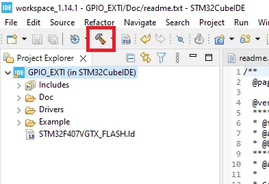

Then click on the "Hummer" button to build the project. When it was completed,

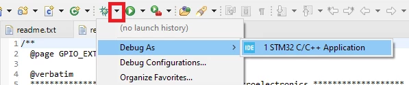

Click on the arrow button shown in red and go to the menu shown below:

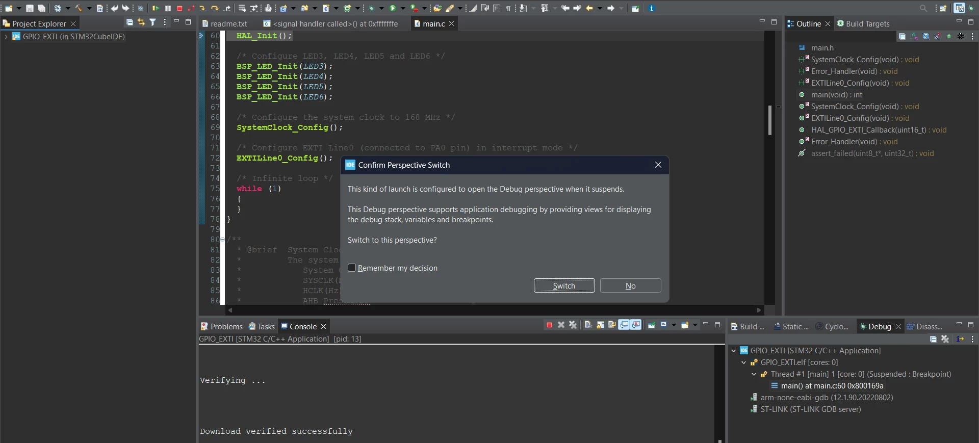

If this window is shown, click OK button to load the program to your MCU target and launch the debug session:

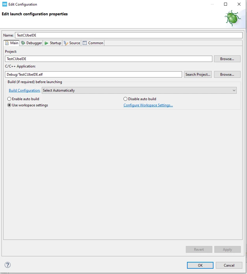

aorkAuthor
March 16, 2024
First of all, thank you very much for your interest, but when I click on the Debug section, this appears and it seems like it is not normal. I did what you wrote step by step. What should I do? I'm so desperate
mƎALLEm
March 16, 2024
Click on switch button and go ahead.
