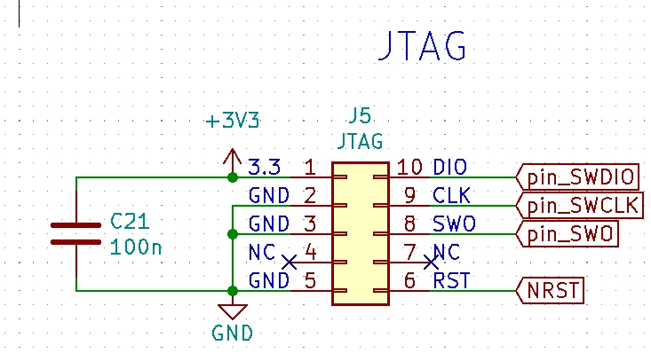

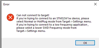

For a project, I created a PCB with an STM32F411 using a 10pin JTAG port for SWD programming.0693W00000HoWkxQAF.pngI tried to connect my card using the ST LINK V2 box and the ST Link utility software but I get the following error:
0693W00000HoWeWQAV.pngThe st link works because I can program another card using a stm32F042. I tried all the connection parameters and to play with the BOOT0 pin status but nothing works.
Can anyone help me to program my card?

So F4 in the circuit is non functional, focus on that and wiring to it.
Check part orientation.
Check voltage seen on VCAP pins, and placed caps.
Check VDDA
Check NRST​

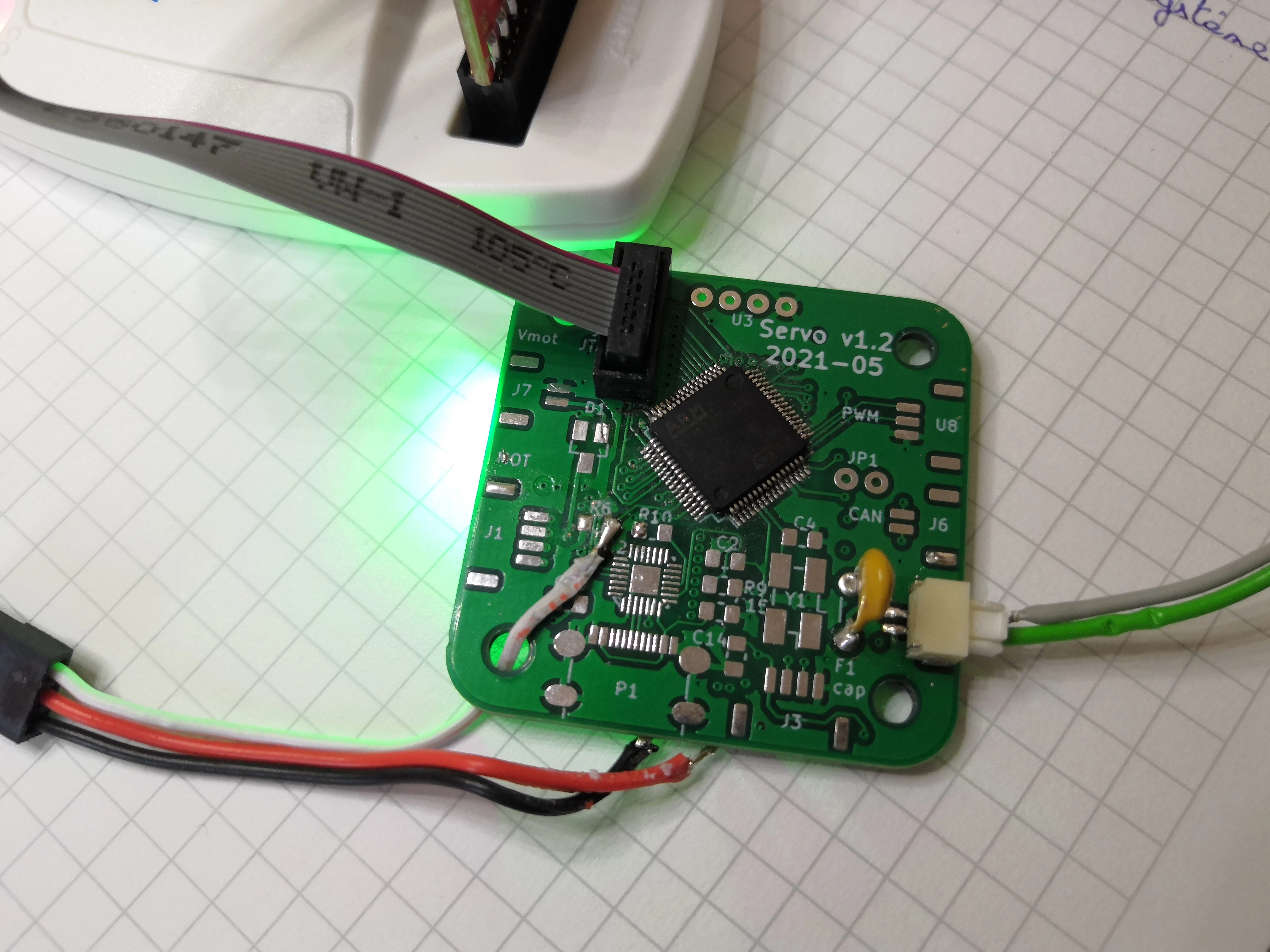

Can you take a picture of the IC on the PCB? Points for clear, sharp and in focus.

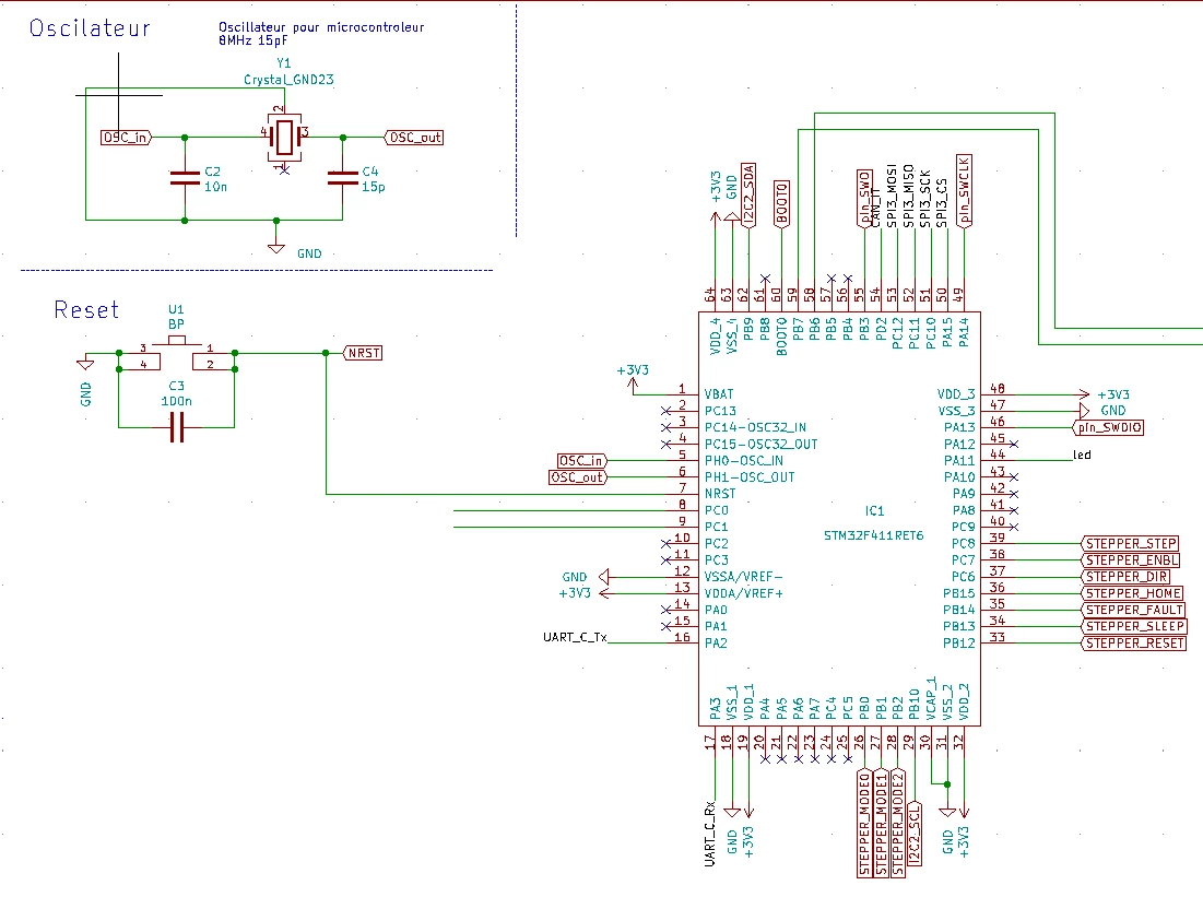

Posting the entire schematic instead of just the debug port pinout would also help. The pinout you show is correct but that doesn't mean the rest of the design is correct, or that those signals are connected to the correct pins on the chip.

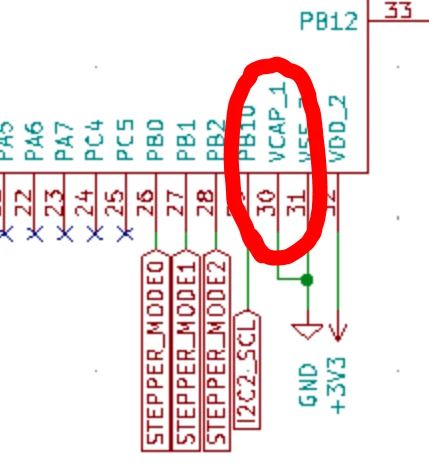

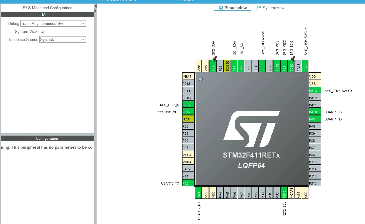

Here is a part of my wiring diagram, the stm32 CubeIDE configuration and a picture of the board. Pin 1 is on the bottom right. BOOT0 is given to a 10k Ohm resistor for which I can choose to ground or 3.3V

You've grounded VCAP. That will cause the chip to not function. This pin outputs ~1.2V and needs to be bypassed to GND with a ~2.2uF cap.
Review the reference layout documentation.
https://www.st.com/resource/en/application_note/dm00115714-getting-started-with-stm32f4xxxx-mcu-hardware-development-stmicroelectronics.pdf

Sorry I didn't see this feature in the documentation. I unsoldered this pin and soldered a 2.2uF capacitor as indicated. Now the card consumes much less and the value seems to me more coherent (10mA instead of 150mA).
I still can't connect to the board but I will read the documentation more carefully before coming back to you.
