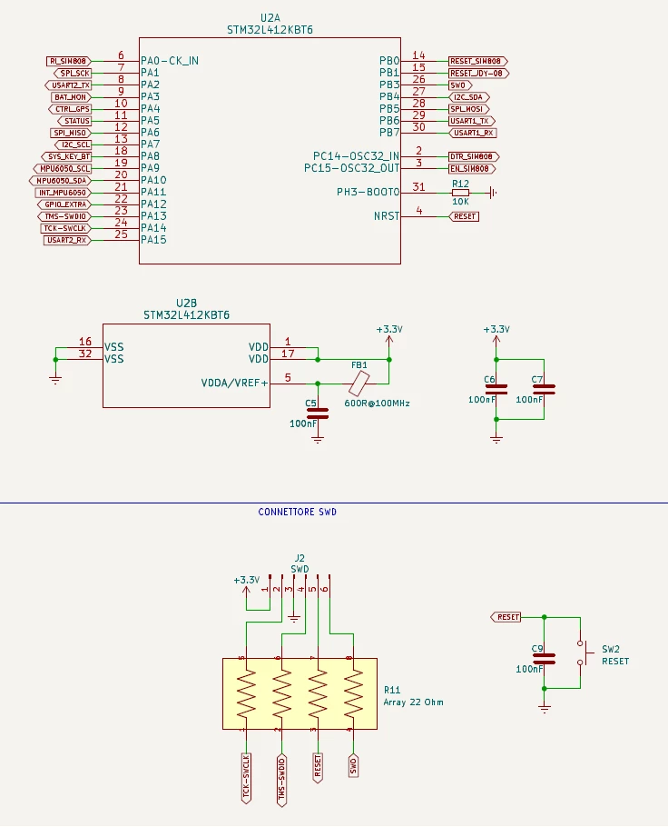

I realized a custom board with a MCU STM32L412KBT6, whose schematic is attached, by using as reference the Nucleo-L412KB schematic.
The problem is that I cannot program the MCU, I am using a STLINK programmer mounted on the Nucleo F401RE (by disconnecting the jumpers on CN4 to disconnect the MCU STM32F401 on the board) and the tool STM32CubeProgrammer.
I also tried to reduce the frequency and change the mode in STM32CubeProgrammer but I obtain always " Error: No STM32 target found!".
The voltage detected in the tool is right (3.3V), the 3.3V is present also on the VDD pins e on the VDDA pin; the reset pin is to 3.3V and the BOOT0 is to 0V.
I tried also to change the MCU with a new but I obtain the same behavior.
At this point I ask you, could the STLINK be unsuitable for programming this low power micro?
Or what could be the problem?
Thanks in advance,
Tommaso

Check pin numbers and orientation
Check not a -P part
Should be workable with the NUCLEO
Target Not Found generally points to power or connectivity issues.

thanks for answer me.
The part number is STM32L412KBT6, isn't present a P character.
What does the letter p stand for?
I check the orientation, It is correct.
I don't know what else to check.

The -P variants use SMPS not the LDO and typically have subtle but incompatible pin configurations.

Hi, I think I have found the problem.
The resistive array footprint used for the SWD is wrong, so I had to fix some connections on the board.
Thanks for the support.
