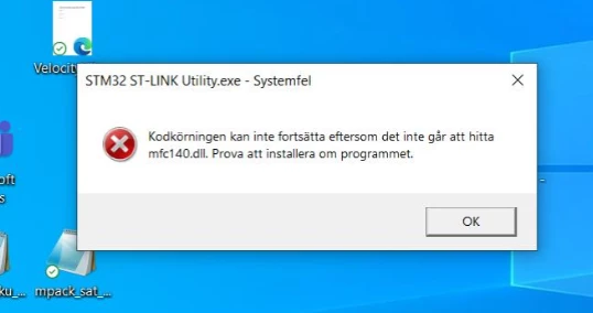

I can download and run STM32 ST-LINK Utility on Windows 10 but my college cant do it on Windows 11 ? Is it possible?

It's not clear what the "can't do it" part describes.
With older software there is often a need to marshal all the correct Microsoft Redistributable packages, usually seen via pop-ups or 0xC0000135 (STATUS_DLL_NOT_FOUND) type errors.
In trouble-shooting issues over at the uBlox forum I found this collection, and this saved fishing specific ones off the Microsoft site, and multiple attempts to find the right one in cascading dependency failure cases.
https://www.techpowerup.com/download/visual-c-redistributable-runtime-package-all-in-one/

Just install a single universal package, which combines all versions since Visual Studio 2015. ST-LINK Utility is 32-bit application, therefore it needs x86 version.
https://docs.microsoft.com/en-us/cpp/windows/latest-supported-vc-redist

Ok, typical error

My college run a version V4.5.0 of ST_LINK.. and now it works.
Yes, it was a clean version of Windows
