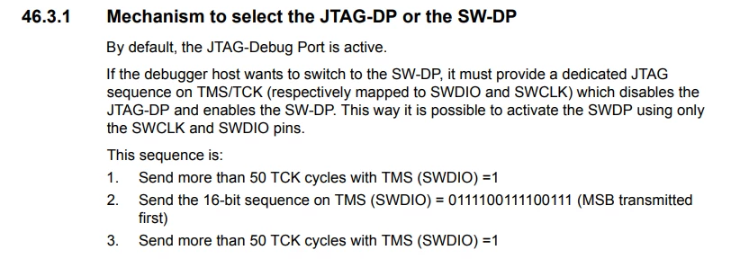

I am working with a stm32l452rct6 microcontroller and when power is connected, the microcontroller is immediately in boot mode. St-link v2 also does not connect. What should I do?
0693W00000LxRk8QAF.pngThis is scheme for debug with swd0693W00000LxRqkQAF.pngHow to do active sw-dp with st-link v2 and stm32cubeProgrammer?
How do you know it's in boot mode?
Try to connect under reset.
If you can connect through some of the bootloader protocols, check the option bytes.

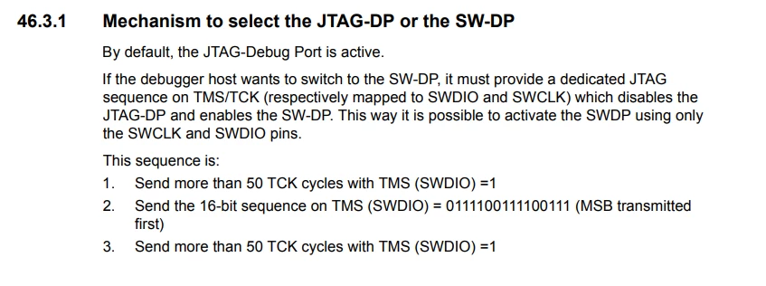

I add second question. Gow to do active sw-dp with st-link v2 and stm32cubeProgrammer?0693W00000LxRqzQAF.png

Check a SWCLK pin it should be Pull-down at Reset state about 10K value.
